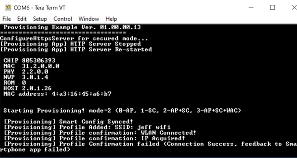

   I am trying the Provisioning Example Program and I am getting at Tera Term output Profile Confirmation Failed? Why do I get this error? I follow the setting of certificates according to the getting started guide.

    The provisioning example and app confirms successful provisioning by connecting the provisioning device (mobile phone) to the same AP and waiting for a broadcast message from the CC3220. If your phone does not connect to the AP or you miss the broadcast, the feedback confirmation will fail despite the profile being added successful.
    For your own end product, we suggest using external or cloud confirmation. You can find more details of this provisioning flow and confirmation in the provisioning chapter of the NWP programmer's guide: http://www.ti.com/lit/swru455

  • Hi Sarah,
         I did not encounter this problem at Out Of Box Demo which also uses provisioning. I have tried the provisioning example program from SDK v1.60 several times and same results. Please re-confirm at TI side.
         At Uniflash image file settings I set these below. Is this correct?
         Private Key File Name - dummy-root-ca-cert-key
         Certification File Name - dummy-root-ca-cert

  • Hi kel,
    One quick comment. It looks that you haven't uploaded ServicePack inside your sFlash for CC3220. I am not sure if this can affect your problem, but is not a good idea use CC3220 without ServicePack.

  • Hi kel,
    I see NWP version at your first port. You have version 3.0.1.4. And for example:
    SDK 1.4 use SP version 3.4.0.0_2.0.0.0_2.2.0.5
    SDK 1.5 use SP version 3.5.0.0_2.0.0.0_2.2.0.5
    SDK 1.6 use SP version 3.6.0.3_2.0.0.0_2.2.0.6
    Yes, I agree that your issue is probably not connected with Servicestack version, but without latest ServcePack you can facing some other issues.
