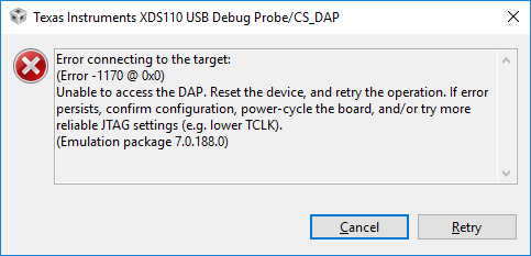

  • So far the best of 3 errors I could not solve.....
    You need to use Uniflash software and set your LP into development mode. Please see e2e.ti.com/.../2131099
    Jan
