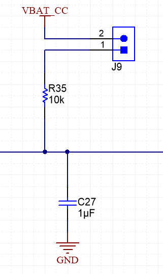

I'm currently making my way through the PCB design checklist for the CC3220SF and have run into a couple recommendations that I am not sure how to address:

2. For the reset (Pin 32) there is an RC circuit recommended by the checklist, and this checklist is reflected by the schematic for the launchpad. However, the resistor in that circuit is only connected to VBAT via jumper J9, and in my testing I've never had that jumper bridged, thus the resistor has no effect on the reset. I have thus omitted that resistor on my board since, but I'm wondering if this is acceptable? I have the reset pin connected to both the UART interface for programming via UNIFLASH and the JTAG header for debugging on my board. Given that there is no resistor in how these connections are wired on the launchpad, I'm assuming this will work similarly.
    There is a reset timing requirement (section 4.14.1 of the datasheet). The RC circuit ensure this timing is met.

  • Hi Charles,
    Thanks so much for the reply. I've made several changes based on your feedback. The only thing I'm still unsure about is that RC circuit attached to the reset pin. I understand what you're saying, but I looked through the design files and found that the resistor would only be active if that jumper is attached. Given that I have never attached that jumper (J9) in my testing and debugging on the launchpad, would it be safe to assume that I could omit that resistor on my board given that the jumper essentially "omits" it electrically on the launchpad? I would certainly still include the capacitors as those are no impacted by the inclusion or omission of the jumper.
    Thank you!
  • Meeting the reset timing is required. You can leave out the resistor if you can ensure the "host" toggling the reset pin meets the required timing.
    I recommended having it placed.
    Is there any specific reason why you want to leave this out? its just one more component on the bom.
    Charles O
  • I'm only omitting it because I'm not going to place the header that's on the launchpad (J9) on my board, so there's no point in placing the resistor. I have nothing against actually including it but I feel like it won't be functional. I have the reset pin on the MCU tied to both the UART header for use with UNIFLASH and the JTAG header, so those should both be able to reset the board as well. Worst case, I think I could simply use an external resistor tied to the UART+reset header to toggle the pin manually should the need arise.
  • For reference, C27 is placed as normal, but the resistor (R35) and header (J9) are not on my board. However the reset wire (horizontal center in this pic) is connected to an external header to be used in conjunction with UART as well as connected to a JTAG header.
    UPDATE: Just tested the launchpad with the pull-up jumper installed and both the uniflash and JTAG programming worked as usual (I thought the pullup would interfere) so I'll just include it on my board given that there seems to be no reason not to and to avoid potential problems. Sorry for the confusion!
