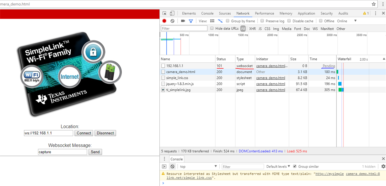

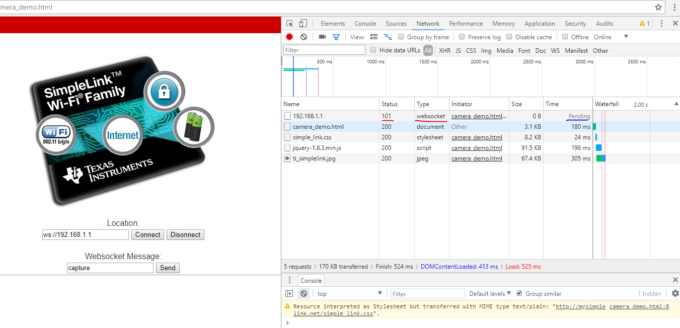

Hi folks, has issue with getting picture from cc3200modlauncxl board.
board connected to camera booster with attached mt9d111 camera board.
the cc3200mod flashed with websock camera application via Uniflash tool
in time of connection I cannot get picture from camera, with following data from google chrome developer
websocket protocol handshake pending all of the time,
maybe somebody faced the issue?

  • IP 198.168.1.1 and I even can get ping from the module,
  • Any debug information? Console prints?
