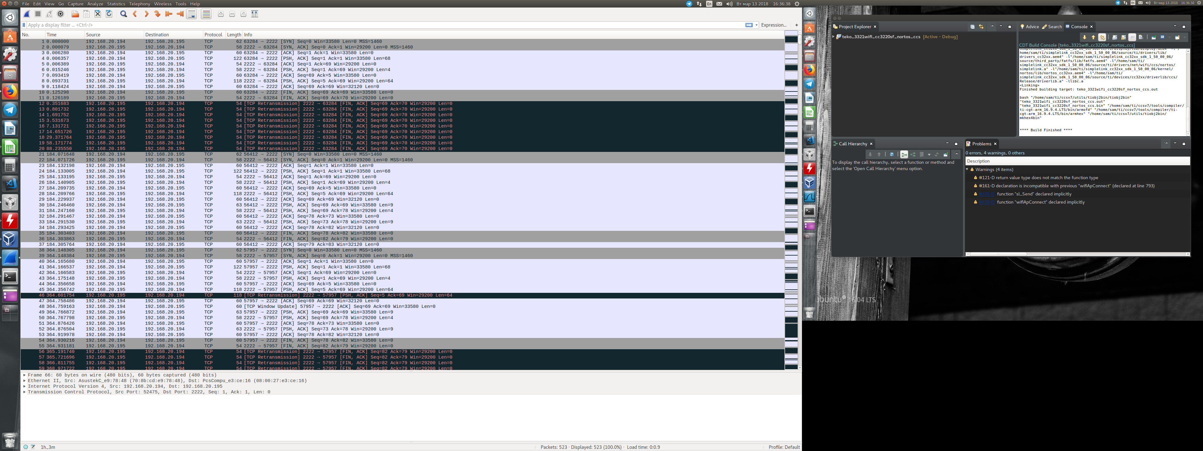

2) I don't know why but when I do sl_Close(sockId);  after send/recv data device  doesn't sent F. frame and server trys to sent F. frame many time
let me show you tcpdump:
where 192.168.20.195:2222 is server and 192.168.20.194 is cc3220sf device
you can see: no ACK to close connection correctly.
and it wakes up and do new socket connection every one minute.
after sl_Close(); a do sl_Stop(timeout); and go to hibernate.
What I have to do to open and close socket connections correctly?

  • >> Do you have a network capture showing the first unsuccessful connection attempt and a subsequent successful attempt?
    tcpdump -w will be ok?
  • first connect and cocket closing (if you ask i'll sent *.pcap file)
    dropped privs to tcpdump tcpdump: verbose output suppressed, use -v or -vv for full protocol decode listening on eth0, link-type EN10MB (Ethernet), capture size 262144 bytes 09:14:15.452467 IP 192.168.20.194.50384 > 192.168.20.195.2222: Flags [S], seq 402080368, win 33580, options [mss 1460,nop,nop,nop,eol], length 0 0x0000: 4500 0030 0010 0000 7f06 90e2 c0a8 14c2 0x0010: c0a8 14c3 c4d0 08ae 17f7 4270 0000 0000 0x0020: 7002 832c 3039 0000 0204 05b4 0101 0100 09:14:15.452557 IP 192.168.20.195.2222 > 192.168.20.194.50384: Flags [S.], seq 3686572925, ack 402080369, win 29200, options [mss 1460], length 0 0x0000: 4500 002c 0000 4000 4006 8ff6 c0a8 14c3 0x0010: c0a8 14c2 08ae c4d0 dbbc a37d 17f7 4271 0x0020: 6012 7210 aaf4 0000 0204 05b4 09:14:15.504719 IP 192.168.20.194.50384 > 192.168.20.195.2222: Flags [.], ack 1, win 33580, length 0 0x0000: 4500 0028 0011 0000 7f06 90e9 c0a8 14c2 0x0010: c0a8 14c3 c4d0 08ae 17f7 4271 dbbc a37e 0x0020: 5010 832c daaf 0000 0000 0000 0000 09:14:15.504767 IP 192.168.20.194.50384 > 192.168.20.195.2222: Flags [P.], seq 1:69, ack 1, win 33580, length 68 0x0000: 4500 006c 0012 0000 7f06 90a4 c0a8 14c2 0x0010: c0a8 14c3 c4d0 08ae 17f7 4271 dbbc a37e 0x0020: 5018 832c 0e1a 0000 4000 0000 0100 0000 0x0030: 8491 d5d5 0bd9 2964 f571 4832 a452 f49b 0x0040: 2f1c ed8b 32f8 3c7a 9329 1d9c e57a 561e 0x0050: e638 0ddf 724b e5fa d1b6 4f25 0c38 aaf6 0x0060: 9bbb c042 09fb d543 b92b 93c6 09:14:15.504786 IP 192.168.20.195.2222 > 192.168.20.194.50384: Flags [.], ack 69, win 29200, length 0 0x0000: 4500 0028 14e9 4000 4006 7b11 c0a8 14c3 0x0010: c0a8 14c2 08ae c4d0 dbbc a37e 17f7 42b5 0x0020: 5010 7210 aaf0 0000 09:14:15.508329 IP 192.168.20.195.2222 > 192.168.20.194.50384: Flags [P.], seq 1:5, ack 69, win 29200, length 4 0x0000: 4500 002c 14ea 4000 4006 7b0c c0a8 14c3 0x0010: c0a8 14c2 08ae c4d0 dbbc a37e 17f7 42b5 0x0020: 5018 7210 aaf4 0000 4000 0000 09:14:15.565197 IP 192.168.20.194.50384 > 192.168.20.195.2222: Flags [.], ack 5, win 33580, length 0 0x0000: 4500 0028 0013 0000 7f06 90e7 c0a8 14c2 0x0010: c0a8 14c3 c4d0 08ae 17f7 42b5 dbbc a382 0x0020: 5010 832c da67 0000 0000 0000 0000 09:14:15.565251 IP 192.168.20.195.2222 > 192.168.20.194.50384: Flags [P.], seq 5:69, ack 69, win 29200, length 64 0x0000: 4500 0068 14eb 4000 4006 7acf c0a8 14c3 0x0010: c0a8 14c2 08ae c4d0 dbbc a382 17f7 42b5 0x0020: 5018 7210 ab30 0000 bfa9 fde0 84b7 7f7e 0x0030: 1c6d 19c9 4595 69f6 aec8 b18b 99d7 3398 0x0040: 1e1c 980f 4dcf b7b5 d788 c488 d4db 2788 0x0050: 6184 3ae8 9e13 a337 e4bd b80b e3f2 0003 0x0060: c59b 930b 572a 4306 09:14:15.607353 IP 192.168.20.194.50384 > 192.168.20.195.2222: Flags [.], ack 69, win 32120, length 0 0x0000: 4500 0028 0014 0000 7f06 90e6 c0a8 14c2 0x0010: c0a8 14c3 c4d0 08ae 17f7 42b5 dbbc a3c2 0x0020: 5010 7d78 dfdb 0000 0000 0000 0000 09:14:15.612847 IP 192.168.20.194.50384 > 192.168.20.195.2222: Flags [F.], seq 69, ack 69, win 33580, length 0 0x0000: 4500 0028 0015 0000 7f06 90e5 c0a8 14c2 0x0010: c0a8 14c3 c4d0 08ae 17f7 42b5 dbbc a3c2 0x0020: 5011 832c da26 0000 0000 0000 0000 09:14:15.613779 IP 192.168.20.195.2222 > 192.168.20.194.50384: Flags [F.], seq 69, ack 70, win 29200, length 0 0x0000: 4500 0028 14ec 4000 4006 7b0e c0a8 14c3 0x0010: c0a8 14c2 08ae c4d0 dbbc a3c2 17f7 42b6 0x0020: 5011 7210 aaf0 0000 09:14:15.882365 IP 192.168.20.195.2222 > 192.168.20.194.50384: Flags [F.], seq 69, ack 70, win 29200, length 0 0x0000: 4500 0028 14ed 4000 4006 7b0d c0a8 14c3 0x0010: c0a8 14c2 08ae c4d0 dbbc a3c2 17f7 42b6 0x0020: 5011 7210 aaf0 0000 09:14:16.412332 IP 192.168.20.195.2222 > 192.168.20.194.50384: Flags [F.], seq 69, ack 70, win 29200, length 0 0x0000: 4500 0028 14ee 4000 4006 7b0c c0a8 14c3 0x0010: c0a8 14c2 08ae c4d0 dbbc a3c2 17f7 42b6 0x0020: 5011 7210 aaf0 0000 09:14:17.512357 IP 192.168.20.195.2222 > 192.168.20.194.50384: Flags [F.], seq 69, ack 70, win 29200, length 0 0x0000: 4500 0028 14ef 4000 4006 7b0b c0a8 14c3 0x0010: c0a8 14c2 08ae c4d0 dbbc a3c2 17f7 42b6 0x0020: 5011 7210 aaf0 0000 09:14:19.672391 IP 192.168.20.195.2222 > 192.168.20.194.50384: Flags [F.], seq 69, ack 70, win 29200, length 0 0x0000: 4500 0028 14f0 4000 4006 7b0a c0a8 14c3 0x0010: c0a8 14c2 08ae c4d0 dbbc a3c2 17f7 42b6 0x0020: 5011 7210 aaf0 0000 09:14:23.912369 IP 192.168.20.195.2222 > 192.168.20.194.50384: Flags [F.], seq 69, ack 70, win 29200, length 0 0x0000: 4500 0028 14f1 4000 4006 7b09 c0a8 14c3 0x0010: c0a8 14c2 08ae c4d0 dbbc a3c2 17f7 42b6 0x0020: 5011 7210 aaf0 0000 09:14:32.552352 IP 192.168.20.195.2222 > 192.168.20.194.50384: Flags [F.], seq 69, ack 70, win 29200, length 0 0x0000: 4500 0028 14f2 4000 4006 7b08 c0a8 14c3 0x0010: c0a8 14c2 08ae c4d0 dbbc a3c2 17f7 42b6 0x0020: 5011 7210 aaf0 0000 09:14:49.832356 IP 192.168.20.195.2222 > 192.168.20.194.50384: Flags [F.], seq 69, ack 70, win 29200, length 0 0x0000: 4500 0028 14f3 4000 4006 7b07 c0a8 14c3 0x0010: c0a8 14c2 08ae c4d0 dbbc a3c2 17f7 42b6 0x0020: 5011 7210 aaf0 0000
