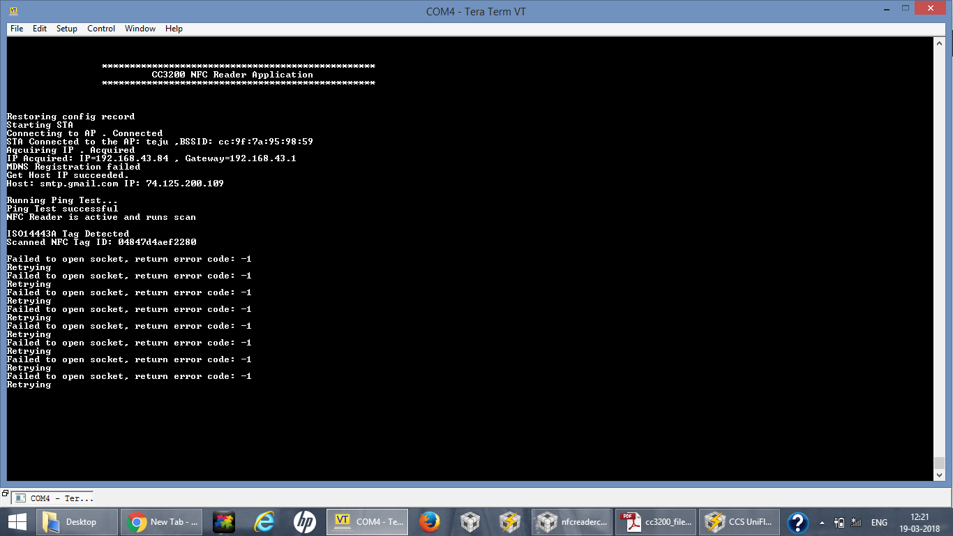

i am getting this error how to overcome this  in this particular applictaion SimpleLink™ Wi-Fi™ Enabled NFC Card Reader...what might be the issue its very important can u suggest us please plase

    It looks like sl_NetAppEmailConnect() fails for some reason when you run the example. You should use the debugger and step into that sl_NetAppEmailConnect() function call, and determine exactly where you encounter an error, and what the underlying error code is. The error code you see of -1 is a catch-all code that doesn't really mean much.
    Let me know what the underlying error is and I'll be able to better help you find the root cause of the problem.

  • Hi cm thejaswini,
    Looking through the email settings, I realized that you need to change the email server settings, as the NFC example uses settings such as SSLV3 that have since been unsupported by Google. Take a look at this thread for the changes you'll want to make:
    e2e.ti.com/.../1943339
    Let me know if changing those email server settings help.

  • this actually helped me .. thank you.
