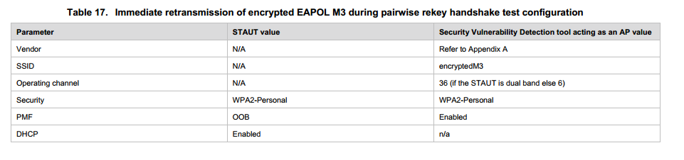

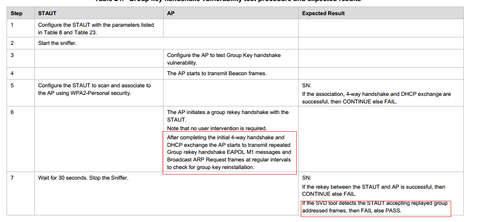

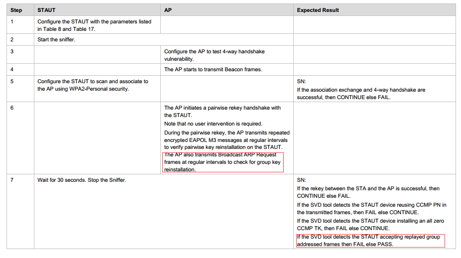

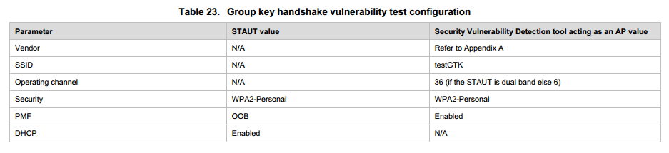

WTS SVD-5.2.3 and SVD 5.3.1 test scenario description:
5.2.3:the SVD shouldn’t detected the STAUT accepting replayed group addressed frames while AP transmited Broadcast ARP Request frames.
Test procedures:
5.3.1:
Test procedures:
Both of them fail at STAUT accepting replayed group addressed frames, the attached contains driver console and sniffer log i think they are useful for you and if you need more information please let me know.
