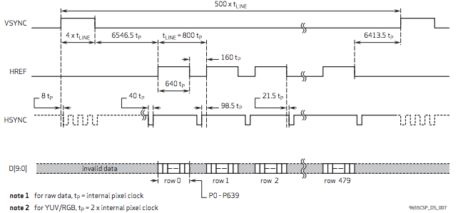

For the past few weeks, I have been trying to get the CC3220 parallel camera interface to work with an OV9655 camera sensor. So far, I have not been able to get the camera peripheral to capture any sort of data from the camera. As this peripheral does not have example code, I did not have anything to base my code off of besides the older CC3200 camera example code. Below is my relevant setup code which I believe is correct based off of other peripherals. This code successfully runs, however the camera callback function never gets called. In addition, I also print out the status of all the camera interrupts and they are never asserted. The only indication that the code is actually doing something is that the CC3220 begins to output the XCLK signal. Beyond this, the peripheral fails to latch any sort of data.

    Are you seeing any issue with the return values from the camera related function calls above? Have you tried probing the relevant pins for data with a logic analyzer or oscilloscope to verify data on the lines?
    It may also be useful to refer to the reference on using the parallel camera interface.
  • Hi Austin,
    Thank you for your hasty response, your urgency on this topic is greatly appreciated! I am working on this project with Nicholas Kimball who originally asked the question above.
    We have spent quite a few hours trying to determine if the functions are all returning expected, positive values and they area. We have also probed all of our pins and verified that the signals all look appropriate and that we can see camera data on the camera data pins. Like Nicholas pointed out above, we have code to print out all of the camera interrupt states repeatedly. Unfortunately, none of the interrupts are being set at any time and it almost appears as though the camera peripheral of the CC3220 doesn't recognize that a camera is connected - perhaps the camera peripheral inside of the CC3220 isn't being powered on??
    The CC3200 camera application that you link is something that we looked at a few months back when we first started this project. Unfortunately, it isn't very useful as the CC3200 and the CC3220 vary quite heavily in their applicable resources, reference materials, and examples.
    Any further information on this subject would be greatly appreciated!
    Shane

  • I believe the problem was with the DMA not being properly initialized. The camera peripheral would fail to start as a result.
