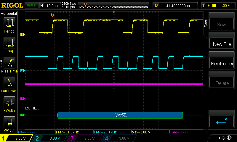

I have been working with the CC3220MODASF module for a while now and I have not been able to get an appropriate I2C transaction due to what appears to be clock stretching. I am trying to replicate the CameraBooster pack design that was released for the previous version of the module, the CC3200. Here is the datasheet for the MT9D111 camera module that I am working with. Attached are two pictures, the first picture is the clock when the physical 6MHz clock going to the camera module is being generated by the CC3220 and then the second picture is when the clock used is coming from an external 6MHz source.
We have the CC3220's I2C set to be 100kHz as can be clearly seen from the oscilloscope screenshots.
Any quick insight into this behaviour would be appreciated. I have been struggling with this issue for a few months with a number of different camera modules.

    the device supports clock stretching when slave requests it - see  section 7.3.10, page 215 and on for the register settings on the timer for this.
    According to this data sheet -
    (page 180) - the camera module is the slave, and therefore responsible for "requesting" the clock stretching. So the above (for the CC3220, acting as the master) will help you adjust the timer value needed to support this module.

  • Shane -
    the basic way clock stretching works is an interaction between the slave and the master, not with an interjected signal.
    Did you catch the slave holding the clock down (which is basically a request for stretching)

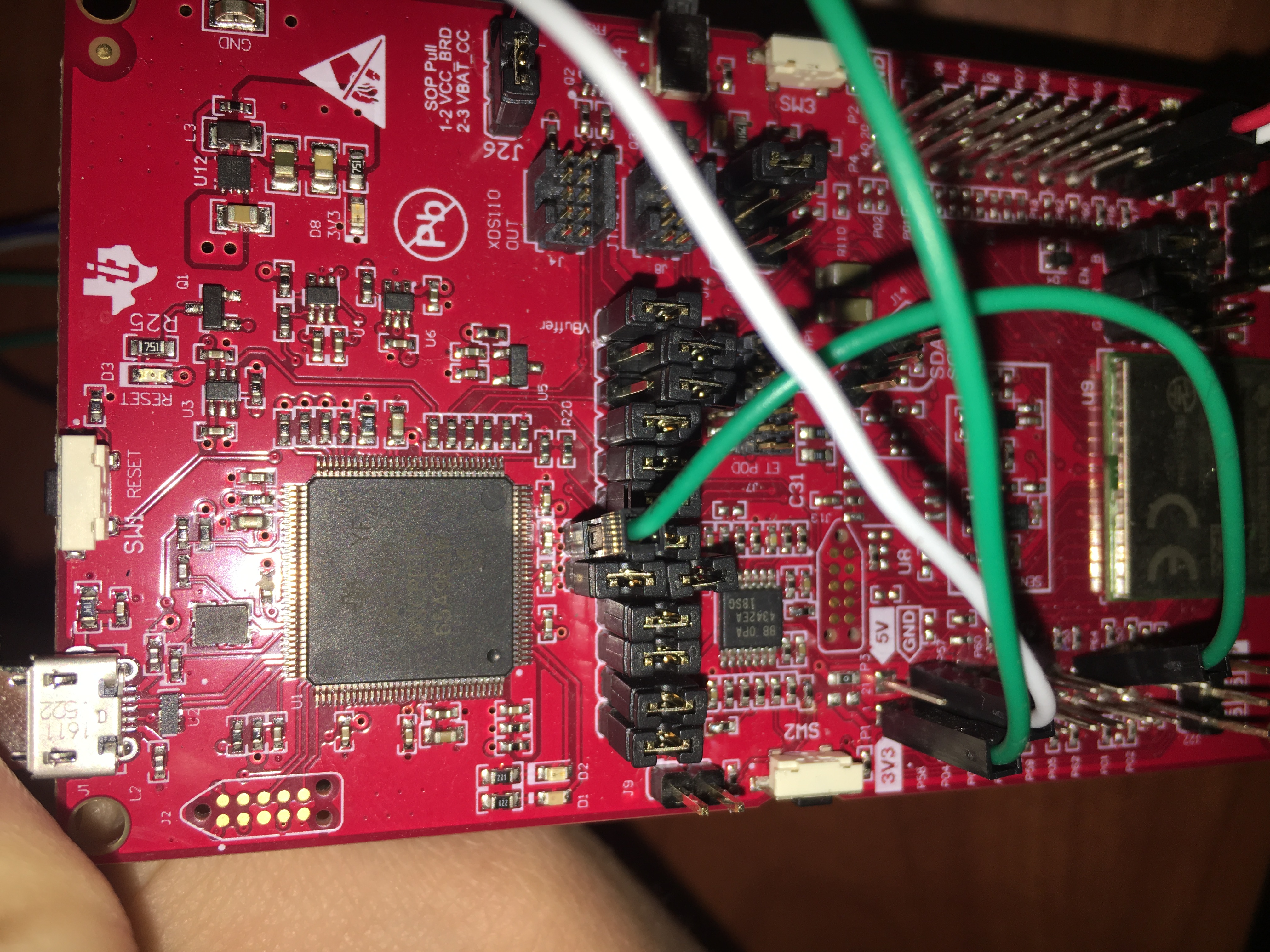

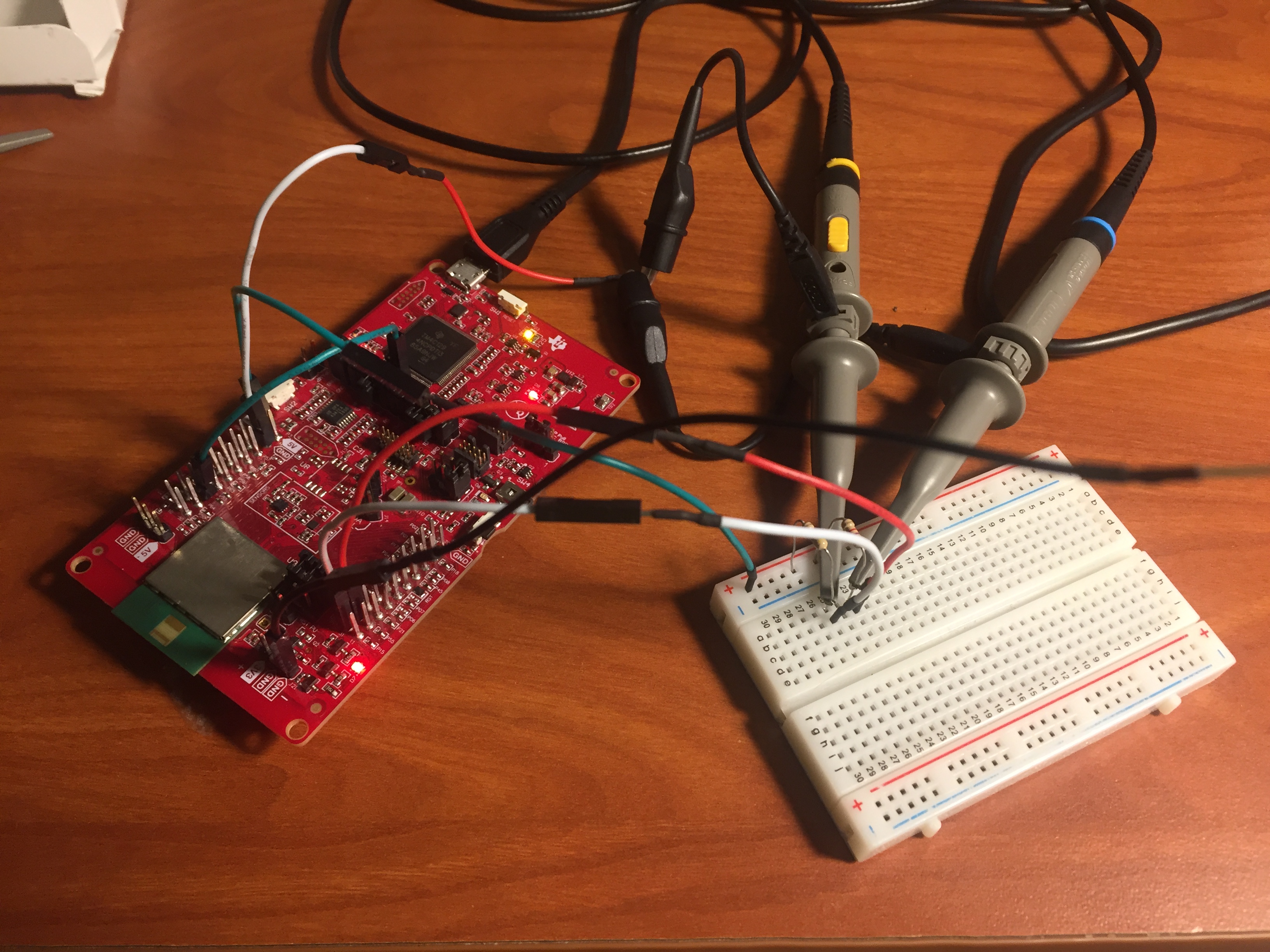

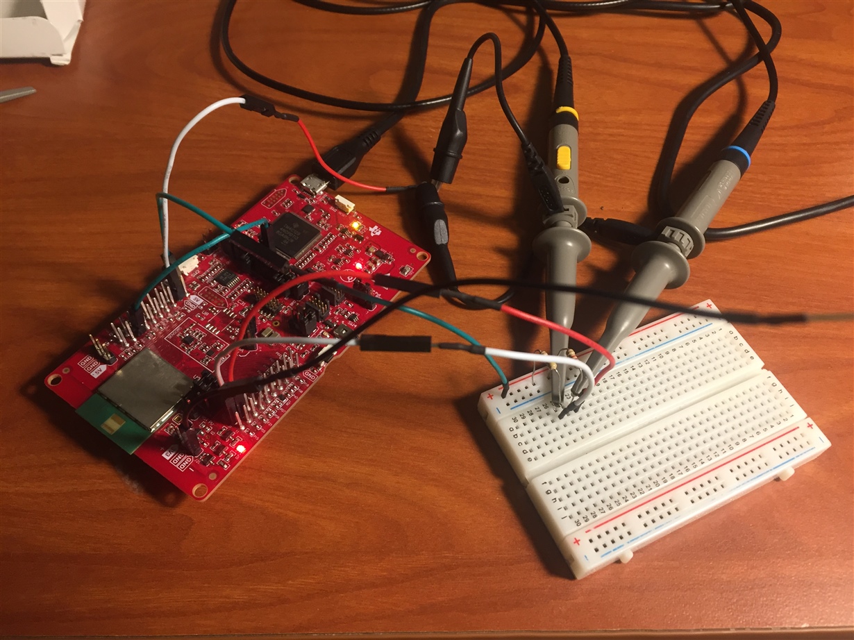

    I've continued looking into this issue.  Attached you will see pictures describing my bench top test setup using the CC3220 LaunchPad and a screenshot of the I2C lines coming from the CC3220.  Notice that there are no slave devices connected to the CC3220 which is acting as a master. The on-board I2C devices have their jumpers for SDA and SCL disconnected.
    The project that is running is the example project known as 'i2ctemp006' that TI provides.
    This is very concerning. It appears as though a scenario that looks like a clock stretching situation is occurring even when there are no slave devices connected to the master and when running the provided sample code.
    I have also tried your suggestion of working with the I2C timing register, even when that value is set to its highest possible value this issue occurs.

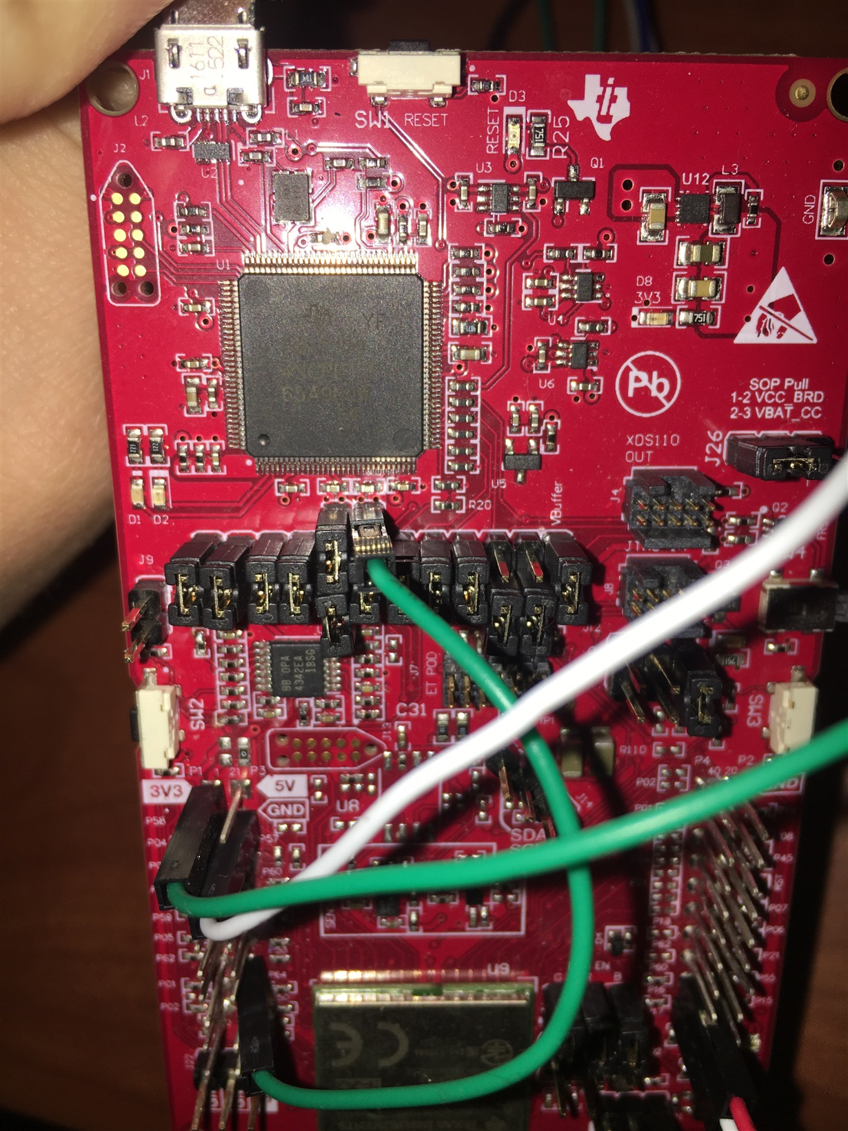

  • Shane -
    i can see you are using pins that are normally used for JTAG, and it looks like the XDS110 is still connected.
    this means you modified the board by moving resistors and changed the code, too. any chance you can check with the default code and default pins for I2C?
    and/or remove the jumpers which connect the CC3220 pins to the XDS110 (P16_GPIO_23 = P16_JTAG_TDI = XDS_JTAG_TDI, P17_GPIO_24 = P17_JTAG_TDO = XDS_JTAG_TDO)

  • Hi Josh,
    It's hard to tell from the pictures that I previously sent you, but you can see that we have the jumpers removed for the JTAG communication. We are programming the board with SWD.
    No matter which I2C pins we use, this issue occurs. We've tested all of these pins:

    R121 and R127 are populated by default to connect the I2C sensors to the part and the headers - this is P02_GPIO_11 and P01_GPIO_10...in looking at it again just now - (i missed it this morning) - i notice that these are also connected to pull downs for the RGB LED.  You can remove jumpers on J23 and J24 to take those out of the equation in case they are the pulldown problem (sheet 1)
    WCS028A(CC3220SFM)_Sch.PDF
  • Josh,
    I can try and update the SDK to v2.10.00.04 if you believe it may improve this situation.
    I have had J14, J15, J23, J24, and J25 all removed.
