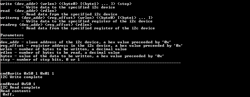

I am interfacing CC3200 with below EEPROM (AT24C) . It is obvious that I2C demo should work fine for any I2C device  by just putting correct device id  (Here for me Device id is 0x50) in example code.
Below are  my observation/ problems
1, If i am writing  in EEPROM by either write cmd or write reg cmd in tera term   result is  I2C write complete.
2. Now after writing if i am reading by either read or read reg command in tera team  always i get 0XFF.
3. If i read full 255 location of EEPROM  result are 0Xff always.
4. It seems that i am not able to write anything in EEPROM. So i tried to 7 bit addressing by replacing device id 0x50 to 0x51 for write operation but its result says ERROR IN PROCESSING CMD.  WP pin of EEPROM is grounded .
5. I am using 3.3volt pullup for SDA and SCL line . I got from data sheet for FST mode 400kbps speed  VCC should be 5 volt hence i have replaced fast mode to std mode in the code.
I struggled alot can anybody  tell me what is the problem in writing I2C EEPROM ??

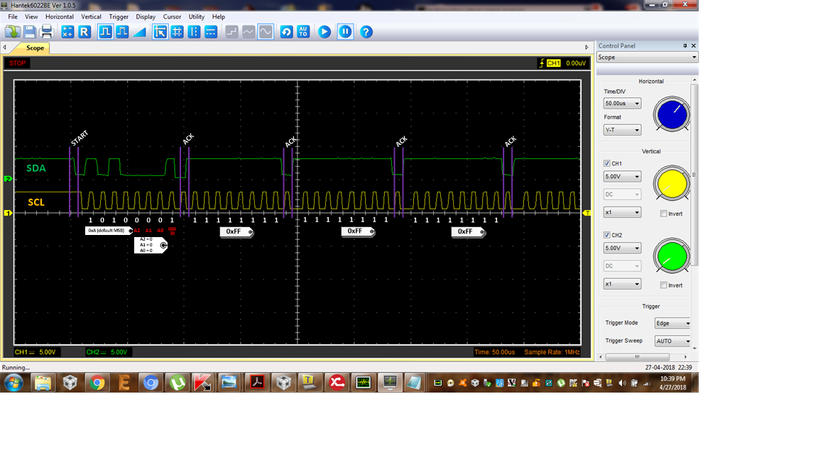

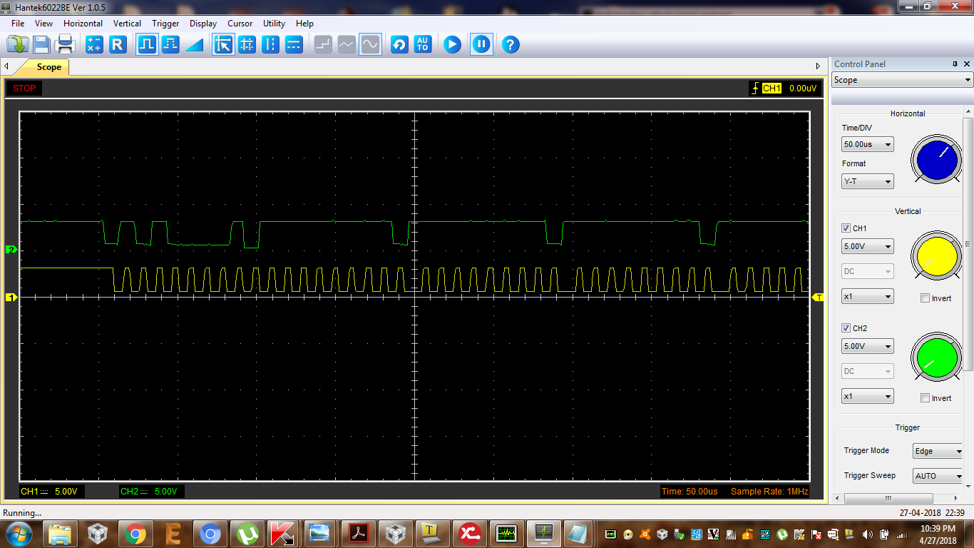

  •  hello josh,
    Thanks for your reply.
    here i am attaching the read data sequence .
  • It seems the everything is fine while reading and factory data may be 0xff at all location.
    I have checked writing cmd with i2c demo and what i got is always SDA and SCL lines are high. I think problem is in writing .
    Please suggest what should i do now.

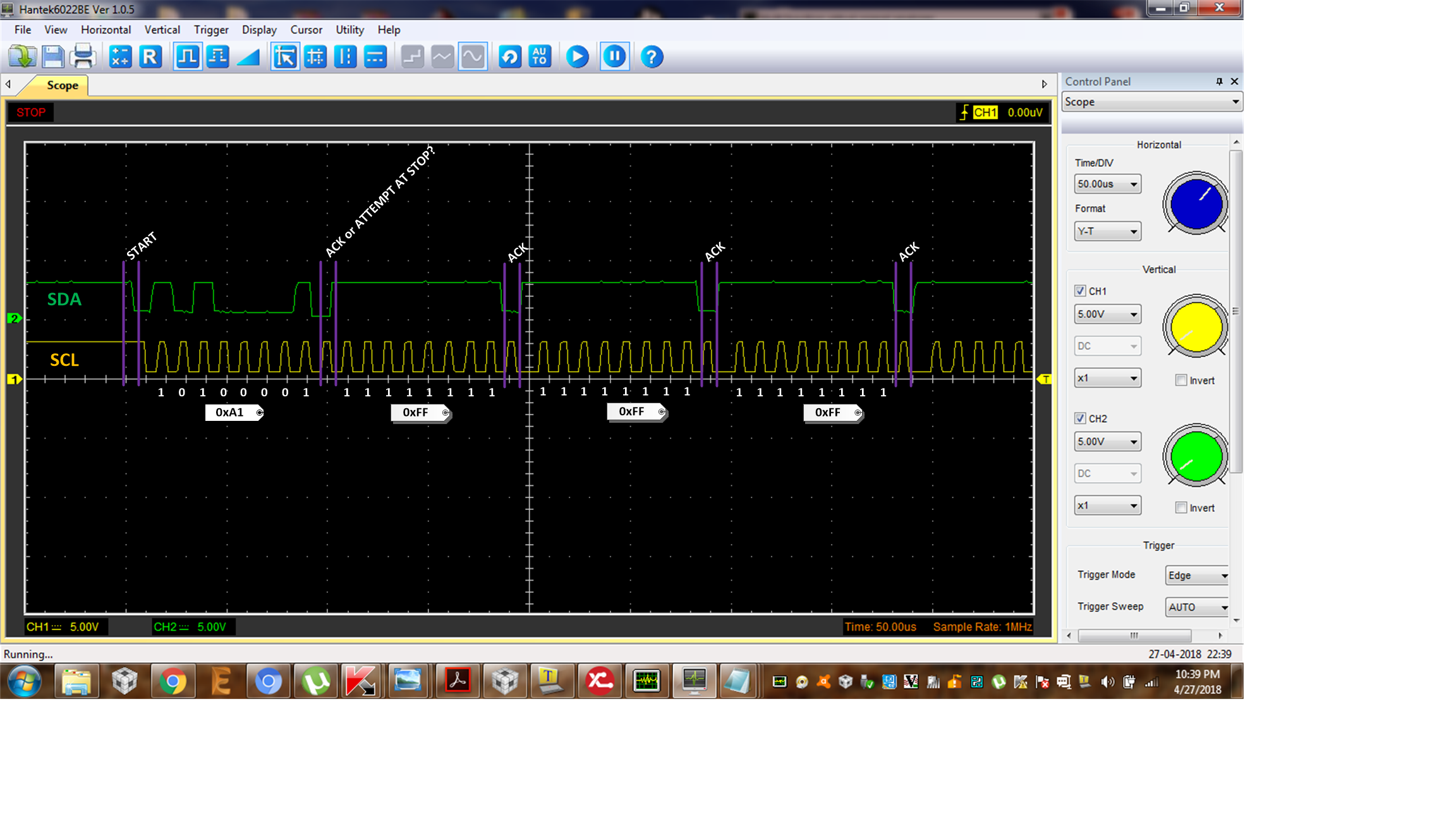

  • Abhay -
    from the EEPROM datasheet ==>
    The AT24C04 uses the A2 and A1 inputs for hard wire addressing and a total of four 4K devices may be addressed on a single bus system. The A0 pin is a no connect and can be connected to ground. (you said you were doing this, but you also said you were connecting A1 to GND, too)
    AT24C04, 4K SERIAL EEPROM: Internally organized with 32 pages of 16 bytes each, the 4K requires a 9-bit data word address for random word addressing. (so you need to use 9 bit addressing - you said you were using 7 bit)
    so i modified your screen capture to show you were i think you are - in this case, i would either double check the schematic for the part you are using and also double check the code you have, in case you have modified or written your own. To me, if the address is supposed to be 0x50, this is not what you are sending - at least from what i can see that you sent over - i was referencing the data sheet of the EEPROM you are using, thinking that you are using the 4k part, since you referenced 512, which is how they call it out.
  • Hello Josh,
    I am using AT24C512 . It is 512k  serial EEPROM.
    Here Address  0xA1 is correct address . Below is the bit sequence for addressing EEPROM
      1  0  1  0    0  A1  A0   R/W
    For reading EEPROM  and with A1 and A0 hardwired to GND  address will be
     1 0  1 0   0 0    0  1    = 0xA1
    Above attached screen shot is for read hence 0xA1 is correct.

  • Abhay -
    so this is actually the datasheet for the part you are using?
    thanks for pointing there - that allowed me to look at this a bit more, as this is a little better of a datasheet - and it matches the part - so based on section 9 - i am trying to figure out your intent.
    here is the modified annotation to your screen capture:
    this i think is now correctly labeled - and it does not match any of the Read Operations shown - the way i see it, if you were doing current address read, the part would have generated a stop condition after one byte (figure 9-1) on page 11 and if you were intending to do random read you would have sent first and second word addresses after device address, etc. (see Figure 9-2, also on page 11) and then there is sequential read, which is preceded by either the current address read or the random address read.
    Double check your addressing please, as i see it you are sending 000 now and this would be allowed by the device if you leave all the lines floating (this what i see in the data sheet) - or you can set it to 0-7 (for eight possibles)

  • HELLO  JOSH,
    Thanks for your support , but i am still in trouble .
    Yes datasheet is exact.
    Yes 0d is correct and same i am using .
    I checked connection to A2,A1,A0 and they all are shorted and Grounded perfectly.
    If i am getting a Zero  (ACK )after sending first 8 bits of address from EEPROM that mean address for write is correct. Otherwise we will never get acknowledge bit from EEPROM(Last line of section 7 of EEPROM  data sheet)
    I have send the logic screen when when i was reading continuously   till 255 location hence the stop condition will come after complete reading of 255 location.
    As per I2c standard every STOP condition  shall be followed by START conditions and than address. You can see in section  9.2 and 9.3 stop condition always followed by start condition. but as i am reading continuously there should not be stop till end of read  .
