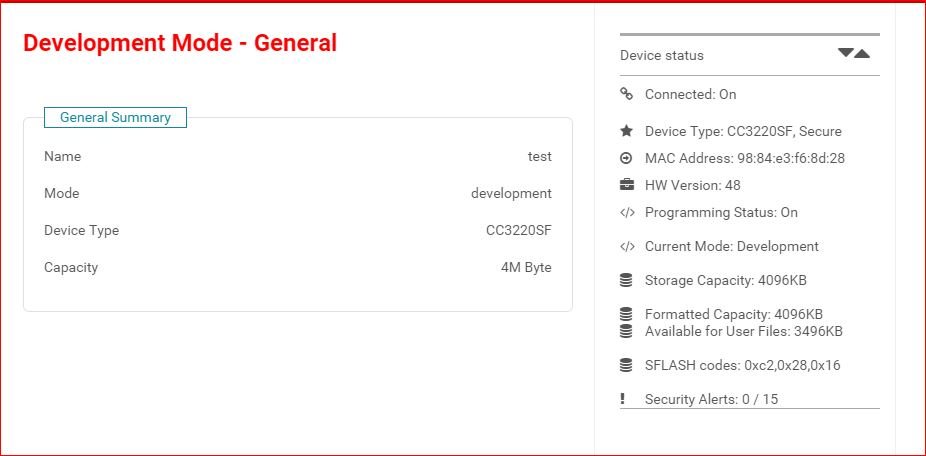

  • Hi Jan,
    Below experiments
    I've set the device in development mode in order to use the jtag.
    Set SOP as "010" to enable both Flash access (through UART) and function mode.
    1) Device is set to Dev Mode  (attached image) in uniflash
    2) With below CCS V8 config
    3) When Verify performed in config - it shows succeeded (below "tail" of screen shot)
    This test will be applied just once.

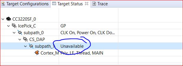

    6) Also in Target configuration window - could see below
    any help???
    Please make sure that you have connected JTAG jumpers (TCK, TMS, TDI, TDO). Also remove firmware image using Uniflash software (you can have uploaded code which switch JTAG pins to alternate functions). Do you have selected CC3220SF.ccxml target configuration file?
    Jan
