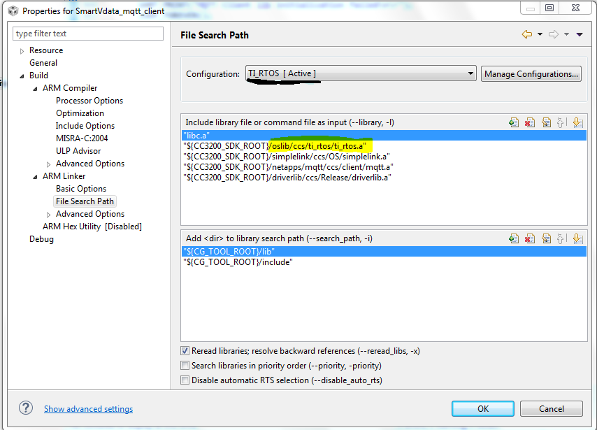

    Under OSLIB you can find 2 adaptation drivers:
    1) free_rtos.a - adapter between the OSI API and FreeRTOS (that is used by default)
    2) ti_rtos.a - adapter between OSI and TI RTOS (this is the one you need to update instead).
    If you have issues with the stack sizes, you can try try to increase the sizes.

  •  Hello Kobi,
    Thank You for replying,
    As per your suggestion i tried making changes on my side,
    And i have attached a snapshot of my screen below with changes please check and verify if i have made correct alteration.
  • Hello Kobi,
    Thanks and Regards
