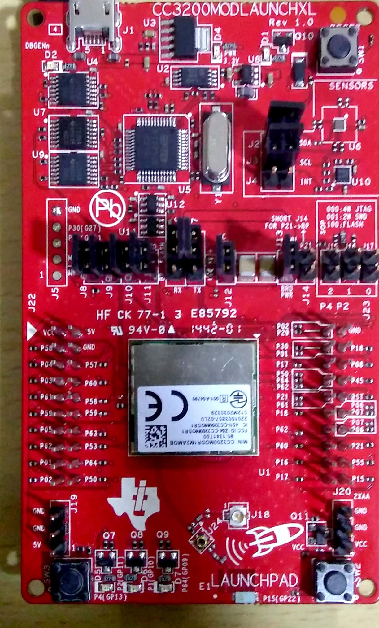

Iam using CC3200 Launchpad and learning TI CC3200 for my new project. it was works fine last 2 week and suddenly stop. I cannot debug from CCS , but can able to flash by Uniflash. I don'r know what was changed in my PC or CCS. I can able to flash and not debug.
Cortex_M4_0: Can't Run Target CPU
Cortex_M4_0: Error
Cortex_M4_0: Unable to determine target status after 20 attempts
This is the error message on my console window. One more thing , if i connect J16( flash programming ) CCS can flash but still not able to debug and have above error.
Please anyone know the solution / this scenario please help me to come out from this...
    Please provide photo how do you have connected jumpers.
    Jan
  • Yes. sure. I did not change any jumper. For flash programming ( uniflash ) i did change.... But for debuging from ccs no connection on SOP
    OK, your jumpers configuration looks OK.

  • Dear fastmahesh -
    Did you try installing J15 ?
  • Yes. That is the jamper SOP ( 100). without that my board and pc not communicating...
    My PC side I was checked any change, yes there is a windows update. but will it effect CCS debug ?
    I was tried to flash FDI chip also...
  • Dear fastmahesh -
    you need the SOP jumper on there. makes complete sense you cannot communicate without it.
    you should not have had to flash a template onto the FTDI IC.
  • is there anyway to reset lauchpad board.....
    problem is it is not running from RAM... so any configuration on debug module changed ?
  • yes. without J15 cannot connect board.
  • there is a reset button on the top right corner of the board.
    i am not sure exactly what you are asking on the second question.
    we have not changed anything on the FTDI side in (at least) two years.
