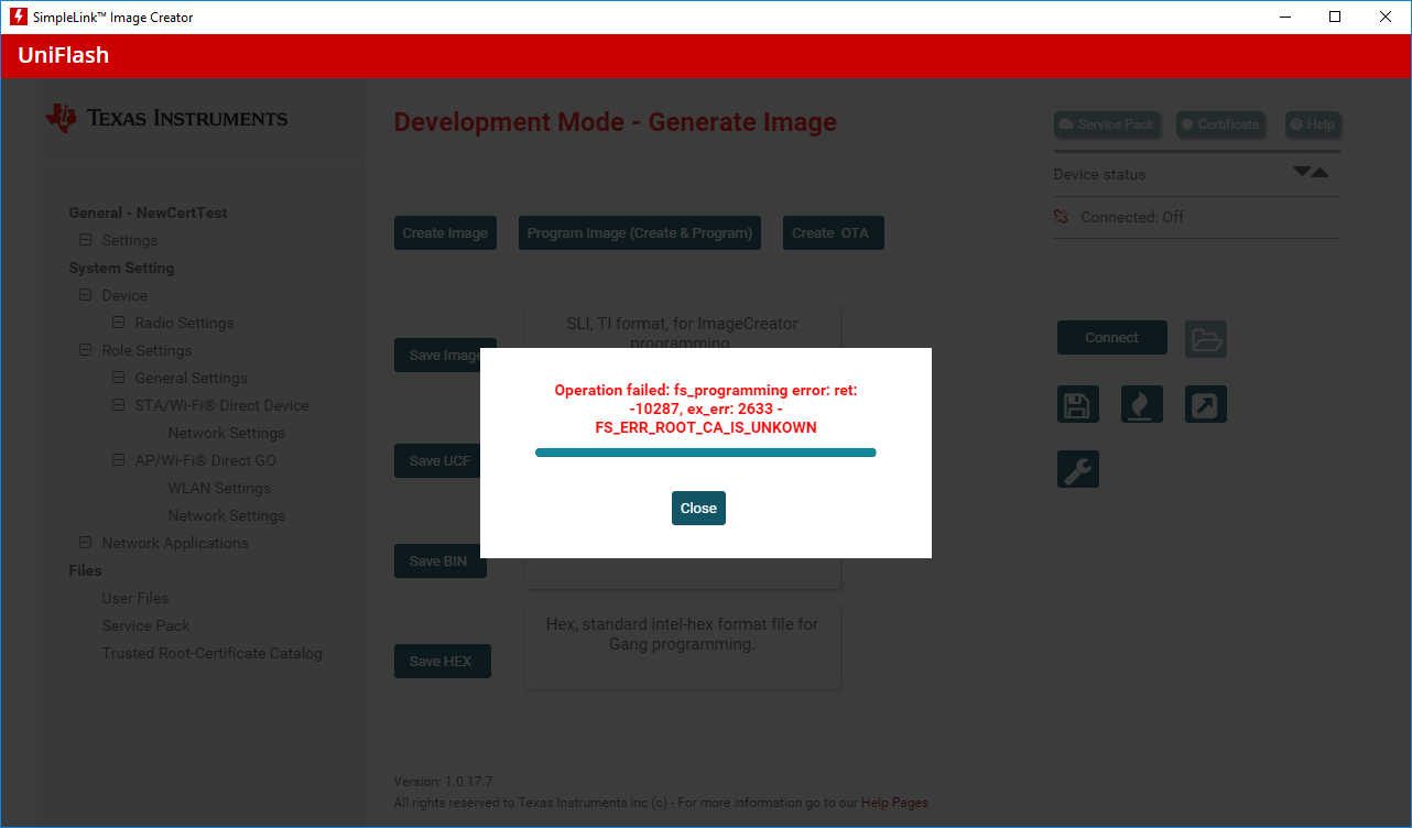

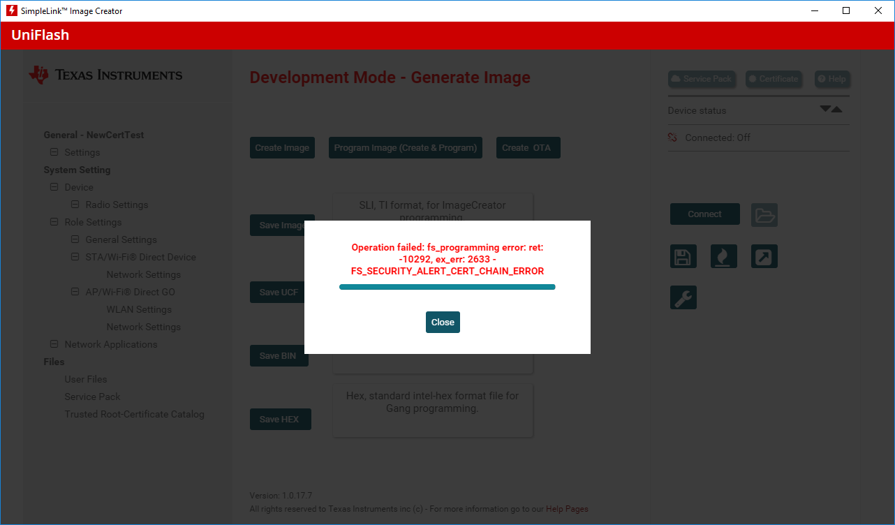

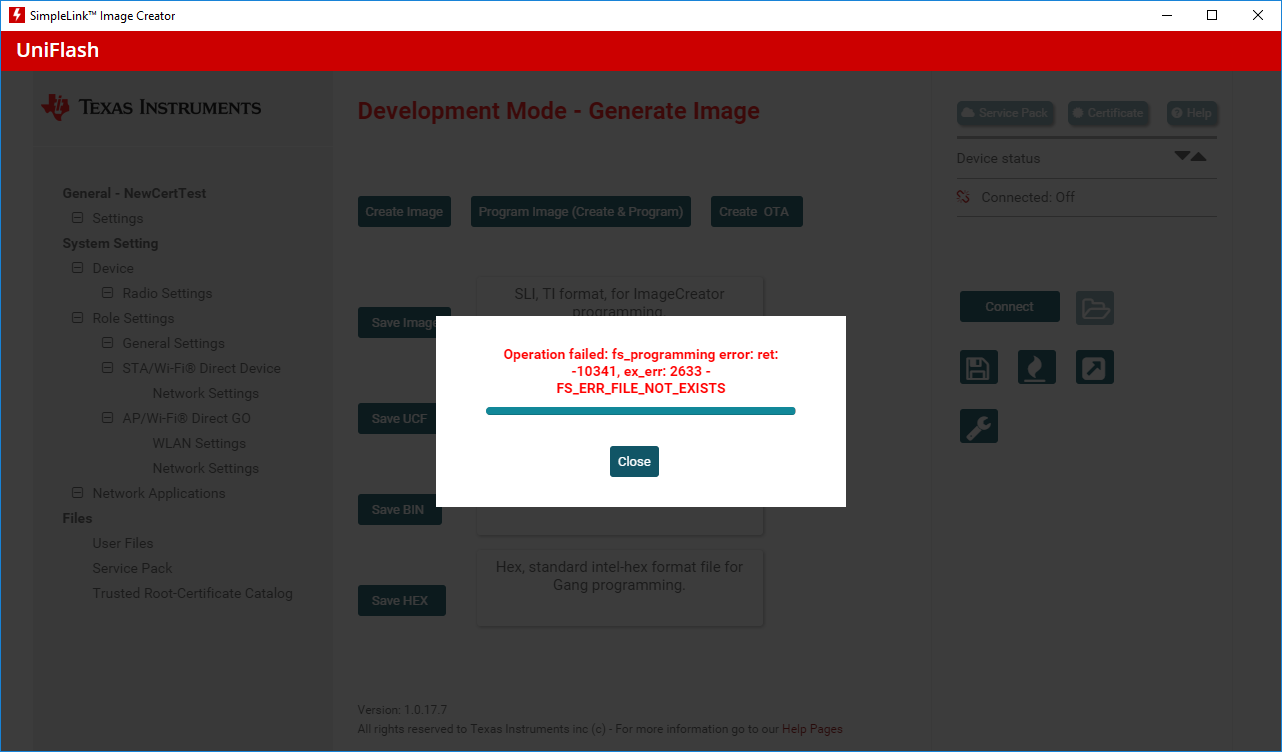

    Now, at the end of programming, I get one of the two following errors :
    I have bought the certificates from Comodo, I received 4 different files of the following format (.crt) : -----BEGIN CERTIFICATE-----   .....Base-64 stuff.....  -----END CERTIFICATE-----
    COMODORSACodeSigningCA.crt, COMODORSAAddTrustCA.crt, AddTrustExternalCARoot.crt, Trelleborg Marine Systems Denm Jakob Poulsen.crt  or cer when exporting from Internet Explorer.
    Any ideas ?
    Thanks !!!
    Br, Vincent.
  • The certificate should be in cer (same as der) format and their name in the FS should correspond to their "common name" - e.g. "COMODO RSA Code Signing CA" (without the ".der" extension).
    Please show me the User Files setting in the uniflash before you program the device.
    Also, I'll contact you directly to send me your public certificate so I can try to reproduce the issue.
    Br,
    Kobi
  • I have tried to remove the extension (.cer) like you said. Now I get this error :
    Here is UniFlash User Files that corresponds to the error above:
    I have sent the public certificates directly to you.
    Thanks a lot for your time !!!
  • Hi Vincent,
    The Uniflash works against the CC3220 boot (ROM) code which does not support SHA-384 as the signature (SHA) algorithm (see details of supported signature types in www.ti.com/.../swru455e.pdf, chapter 7.4.7).
    The Comodo intermediate certificate ("COMODO RSA Code Signing CA") uses the SHA-384 that causes the failure.
    Note that the SHA-384 is supported by the CC3220 service packs and can be used to verify the chain when written from the host (for example during OTA).
    Your options:
    1. Replace the certificate chain with one that only uses SHA-256 (or other supported method). This limitation is relevant for the user and intermediate certificates (the signature algorithm of the root CA certificate doesn't impact the chain verification, so any method will work).
    2. Prepare a production line environment that supports the SHA-384. This will include the following steps:
    - Using Uniflash, install a loader application with a dummy (Playground) certificate (using the Playground certificate store).
    - The loader application will be used to:
    - install the official certificate catalog and commit it.
    - load the application image (for example as an OTA tarball image). Uploading the image will be done over SPI or UART.
    - Install and commit the image (using the OTA library)
    3. Wait until we provide a solution that is based on option 2. We are planning to add such support in one of the coming SDK releases (we don't have a date yet).
    Br,
    Kobi
