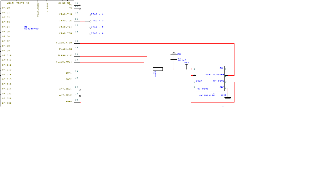

I have tried the solution proposed in the linked thread but that didn't work for me: at the step where you connect directly to the DAP (right click on it and then "connect target") i still get the same error (Unable to access the DAP etc).
I also have made a custom board but with the CC3220SF. I have the 4 JTAG signals accessible (TDO, TDI, TCK and TMS). I connect the XDS110 probe to my board with the 20 to 14pins adaptator.
The SOP jumpers are set to pull-down (FUNCTIONAL_4WJ) and the board is externally powered (3.3V).
Which tests can i run to see what's happening? I double checked the hardware and everything seems fine.

  • Hi Kateline,
    In case of you cc3220 is properly set into development mode (please check image in Uniflash):
    You should check this:
    - that JTAG pins are properly connected (TDO, TDI, TCK, TMS, GND)
    - you have set proper SOP configuration (JTAG/SWD) according set target configuration in CCS
    - make sure that you not have uploaded firmware image inside sFlash which switch JTAG pins to alternate function (=upload empty image by Uniflash)
    Jan

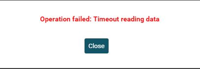

    So I tried to program the image on the chip (as you described above) but i get the same message i got in the beginning:
    After that, the device appears as disconnected in uniflash and i can't reconnect it directly: i have to reboot it (take the battery off then replug it).
    I didn't change anything to the connexions in between...
    Any idea?
    Kateline
    EDIT: i've noticed just now that when i click on "program image", the window with "creating image" shows up, the device is still connected but then right after the window updates to "starting...", the device's status changes to disconnected!
  • Hi Kateline,
    I haven't much ideas why it is not working writing image from Uniflash GUI. How do you have currently set SOP configuration? Do you have connected RST pin to CC3220 to XDS-110?
    If you have already created image by Uniflash GUI, you can try program image via Uniflash CLI. Command line command can look like:
    c:\ti\uniflash\dslite --mode cc3220 project program --name your_project_name --port COM5 --dev
    Jan

  • Hi Vincent
    Sorry for my late answer, I was on vacation!
    So here is what i can show you of the schematic (i can't show you more publicly as it is a proffessional project):
    Do you need to see more parts?
    This is what i get from uniflash when i connect my board:
    Thanks for your help,
    Kateline
  • Hi Kateline,
    I am confused. What device do you exactly use? At your schematic is written CC3200MOD but pinout is not correct. It looks that you use CC3220MOD but why you connect external flash to module? Module have already embedded SPI memory inside (4MB). Pins FLASH_ are only for a external flash programmer.
    Jan
  • Hi, i've never noticed the typo but it is indeed a C3220MODSF (not CC3200MOD) that i'm using, sorry for that.
    I'm now confused with your remark... I can't connect a memory to the FLASH_ pins?
    Kateline
    Yes, this pins are for external SPI programmer only. You cannot connect another flash chip to this pins.
    Inside the module is 32MBit flash integrated already. You don't need connect another memory to module. External flash is mandatory in case of usage QFN CC3220SF chip. From CC3220MOD datasheet "The four modules integrate the 40-MHz crystal, 32.768-kHz RTC clock, 32-Mb SPI serial Flash, RF filter, and passive components."
    Jan
  • Hi Jan, thanks for your answer... the whole memory management chapter was clearly not... clear to me.
    I'll remove the chip then. Its presence could be causing all the trouble?
    Definitely. You have connected two SPI memory chips to same CS signal. This cannot be functional.
    I think your confusion comes from that you read datasheet for CC3220SF QFN chip not for MOD.
    Jan
  • Said like that, it seems obvious.
    It might be that, i'll start by rereading the documentation.
    What are the FLASH_ pins for then? They are used to configure the SPI flash inside the chip?
    And, so that it is perfectly clear to me, what is the difference between the CC3220SF and CC3220SFMOD? (And the "SF" specifies that there is an extra internal flash memory - right?)
    Thanks again for your help,
    Kateline
  • Hi Kateline,
    - Pin FLASH_ at CC3220 modules are used for mass production. In Uniflash you prepare image and this image you upload using external flash programmer (e.g. www.elnec.com/.../ or www.totalphase.com/.../ ). Usage of external SPI programmer allows fastest production (you don't need to use UART).
    - MOD is a module with CC3220 chip inside together with SPI flash and other components (XTALs, RF filter).
    - Yes, SF have 1MB XAP flash inside chip. This XAP flash is used for code execution. Code from external flash is at boot time "synchronised" with XAP flash. With SF you have 1MB space for code execution. With S device you have only 256kB RAM for your code + data.
    - SF devices are better if you expect bigger code, S devices are slightly cheaper.
    Jan
  • Hi Jan,
    Removing the extra flash memory solved everything... Thanks a lot! :)
    That is great that you was able resolve your issue (and save few cents for external flash :)).
    Jan
