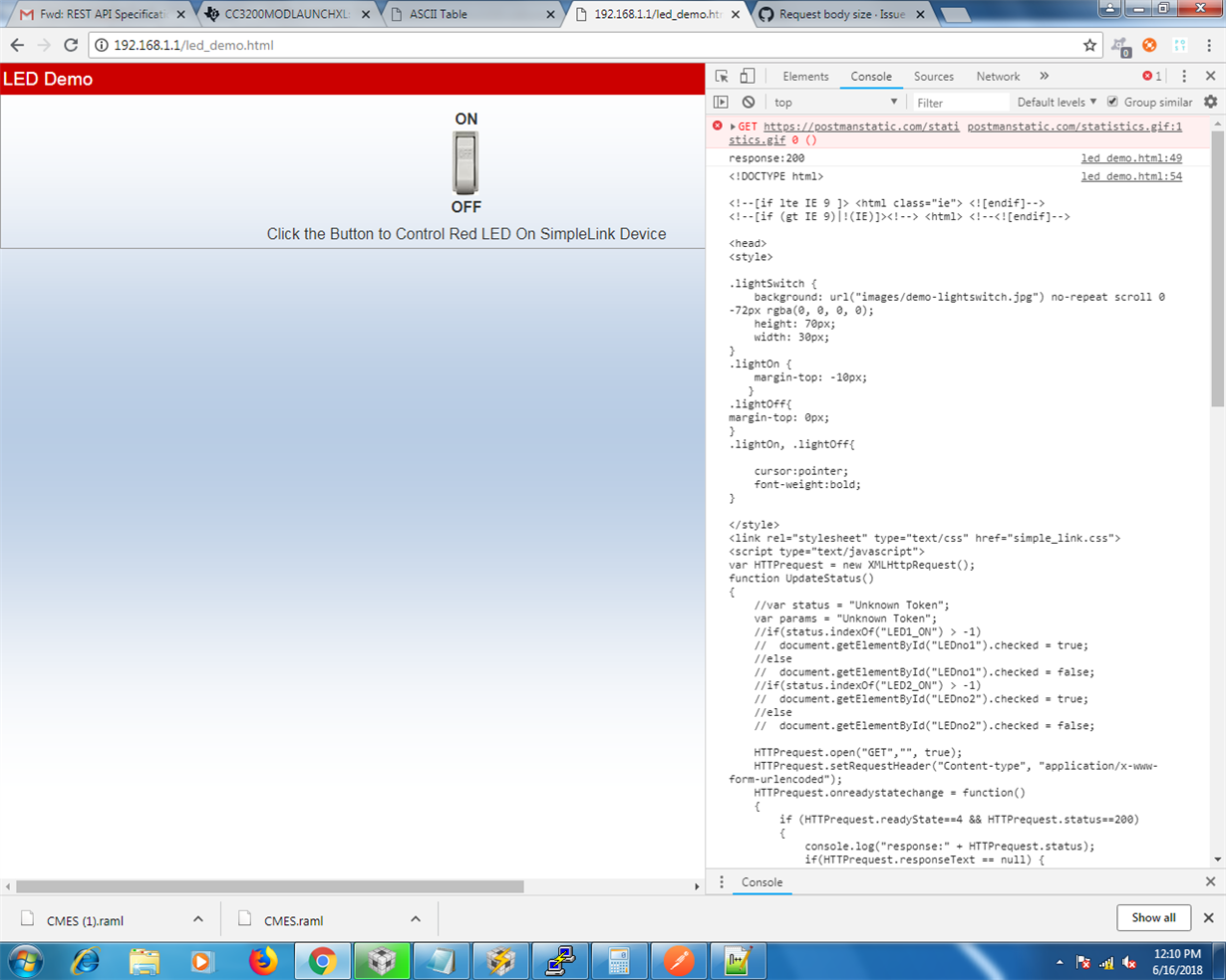

  • Hi Michael,
    Our project contains CC3200MOD as main processor and a secondary processor for business logic

    With regards to above,  below are queries -
    1.  Testing has been done for POST method using  Postman tool, during testing one thing is observed with respect to the value being passed
          Only 40 characters are being allowed to be passed as value, anything beyond that are truncated.
          Even the HTTP callback handler is not being called.
          I have checked to see if this is due to Postman truncating the string. But from below post mentions that more than 40 characters are
         handled seamlessly.
         Is there any restriction on the length of the string that can be handled by the webserver inside CC3200MOD.
    2. Regarding GET method, the httpserver example itself was used.
        As a response, the server returned 204 and No-content.
        When I tried to print the response text and response in led_demo.html, I see the whole webpage being sent instead of LED1_OFF,LED2_OFF string.
        What could be the reason ?
         Below are the screenshots for issue 2. Also attaching the led_demo.html modified file, (modified part of the code)

    To iterate, the two issues are
    1. Token value restriction if any for the webserver
    2. How to read the response of GET request.
     Thank you very much.
    Vamsi.
  • Hi Vamsi,
    1) The max length of the token should be 64 bytes, and not just 40 bytes. That being said, the max amount of data might still be too little for your use case.
    2) The behavior you are seeing is normal. When the internal HTTP server of the CC3200 receives a GET request, it will send back the contents of the GET request target. Furthermore, if the GET request has a HTML page as its target, it will check that HTML page for any custom tokens, and then perform token substitution and replace each token with an internal value or a value provided through the HTTP server callback. You cannot simply send back a single JSON value unfortunately.
    As you can tell, the internal HTTP server of the CC3200 is quite limited. I suggest you take a look at a software HTTP server that runs on your MCU, such as the web server used in the websock_camera example.
    Alternatively, you can also just run a simple TCP socket that your android terminal can connect to, and send back exactly the data that you need.
    Michael
