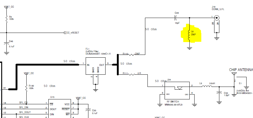

  • I am using above circuit for antenna, what is the value of L8( highlighted) i juat want to give UFL, not the chip antenna.
    L8 and C49 are here for antenna impedance matching (50 Ohm impedance). Values should be determined after measurement at particular board. For this measurement you will need RF equipment. That means spectral analyser for direct measurement or RF generator and other equipment for comparison method. Other option is calculate RF paths (or copy design from reference board), create your own board and test board in real conditions and hope that your RF design will not be poor. RF design without proper measurement is always risky and depending or yours RF design experiences.
    Maybe I should mention that schematic above is for CC3200 QFN chip. In case of you want to use MOD you don't need connect RF filter (FL1) into RF path, cause is integrated inside module already.
    Layout guide for CC3200 QFN is available here ( www.ti.com/lit/ug/swru370a/swru370a.pdf ). Though it is for QFN chip, information about antenna design are related to MOD as well.

    So you are saying that i can connect the RF_BG pin of Module directly to the UFL Connector, rather than through LC circuit.
    No. I say that you need set matching circuit according particular board. Values can be selected after RF measurement at your board.

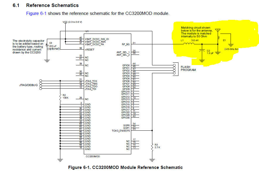

  • Actually i need to use CC3200MOD,\
    1) if i dont know about impedence matching, how can i just connect the UFL Antenna and by which circuit;
    2) Previous module which i have used was for ex. ESP32 Wrover-I; there just i needed to connect the Antenna;
    Just i need to know that how could i interface an antenna with this CC3200MOD, i m bit confused.
    If i use above circuit then, do i have to use L1 and C2 ? what is the two ground symbol after that; one is antenna and what is the other;
    If not this which reference circuit i should use to connect antenna
    Thanks for such quick support.
    Antenna impedance is important parameter for any RF device it is not important whether it is CC3200 or ESP32.
    Module ESP32 Wrover-I have UFL connector on module already. From this reason you don't deal with the proper impeder matching on your board. Only you need select proper antenna. TI module CC3200MOD does not have UFL connector on module. But some 3rd party manufacturers have available module with CC3200 with UFL connector.
    If you not have experience with RF design, you should ask for help to someone with this experiences. If this is not possible, my advice is to take reference design and use it as close as possible at your board. That mean same number of layers, same plating and board thickness, same material of board, same antenna path width, etc. For calculation of impedance at PCB exists many software tools - e.g. www.saturnpcb.com/pcb_toolkit.htm
    Jan
  • 1) can you please provide the reference design link please;  i m not getting which reference design you are referring.
    2)If i use above circuit then, do i have to use L1 and C2 ? what is the two ground symbol after that; one is antenna and what is the other;
    1. Good example of RF design with CC3200MOD are design files for www.ti.com/.../CC3200MODLAUNCHXL and chapter 6.3 in datasheet.
    2. Impedance matching circuit depends on your RF design (PCB layout) and used antenna. I cannot say exact values which will suits into your design. I cannot say whether this parts are mandatory at yours PCB. This matching circuit may/may not be required.
    At schemas above is used chip antenna (from this reason "slightly confusing" schematic symbol).
