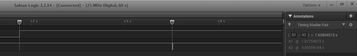

  • Hey Shai,
    I've tested and measured the time from reset and hibernate until the AT Command is ready using a CC3220SF LaunchPad and logic analyzer.
    From reset to command ready, I measured 1.6s.
    After waking up from hibernate to command ready, I measured 2.6s.
    Hope this helps,
    Seong
