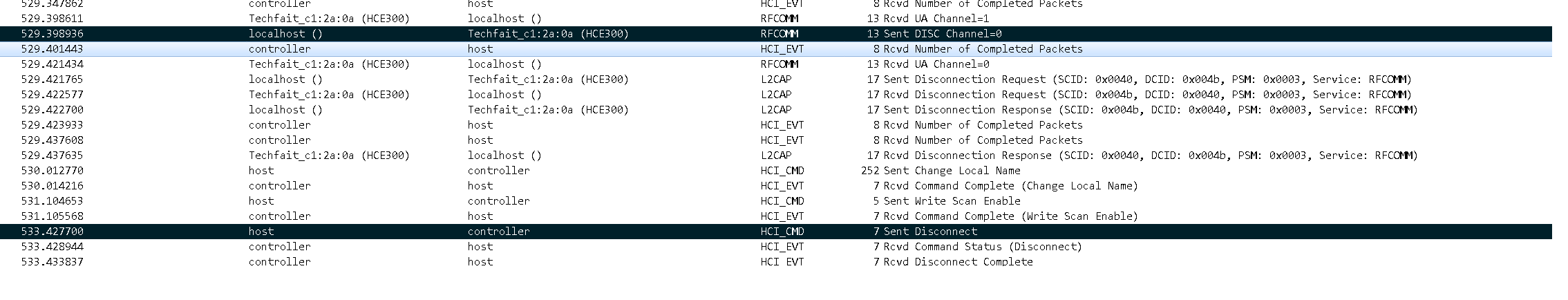

  • Hi Hari,
    We use "hcidump -i hci0 -Xt -w" to captured the log , and we can open it on wireshark. as shown below.
    I also added this log file to the attachment , can you help me review  the log and give some comments?

    Reviewing the logs, it appears in all 3 instances Host application/Bluez profiles (SPP/RFCOMM ) initiated the DISCONNECT. There is no disconnect from the controller as such..
