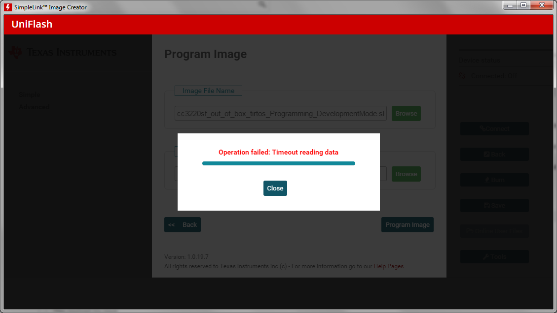

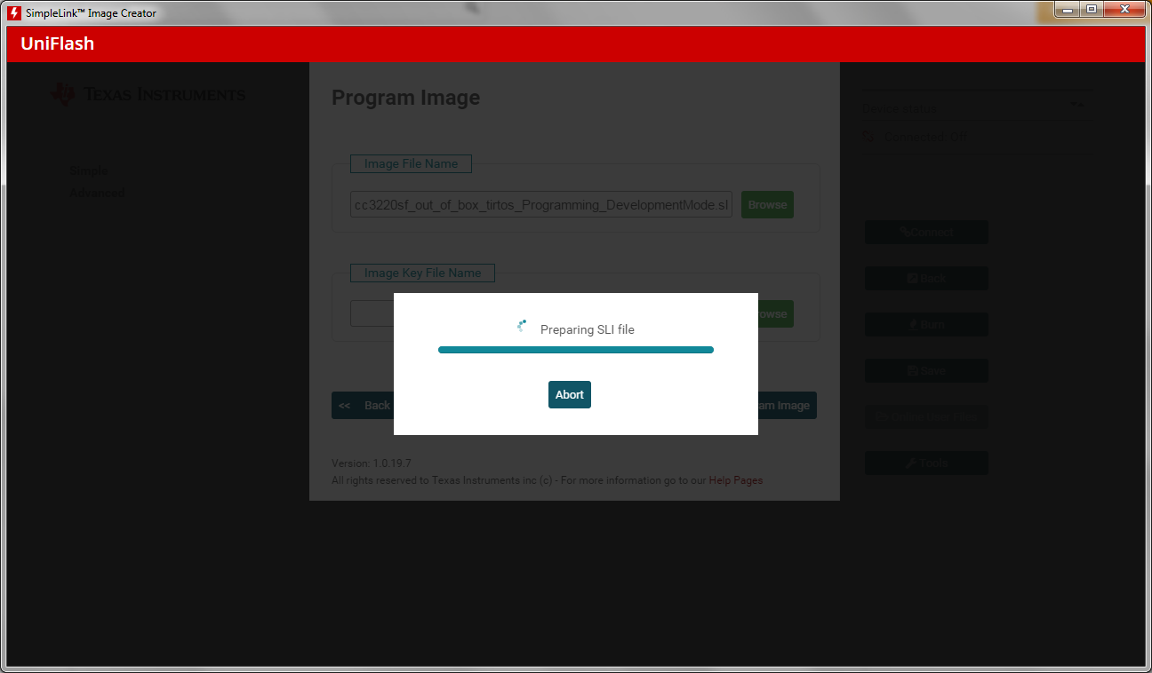

    I am still not able to load to our customer PCAssembly. Our technician scraped away the edge of the CC3220MOD and soldered two tiny wires to pins 46 and 47 and I have connected them to the UART connections on Launchpad so that the TX out of the LaunchPad went to the RX of the target and vicer versa so that output goest to input.
    When I try to program our PCAssembly the UART pins begin both high and for a time while the UniFlash reports that it is prepairing the SLI file the TX from the PCAssembly goes low then when the UniFlash reports Opperation Failed the TX from the PCAssembly goes high again.
    It is not clear to me what goes on with the MAC address that I had to give the GUI when making the dot SLI file for the device on the Launchpad and what or how I am supposed to something with the MAC on the target PCAssembly.
    Hoping for an explanation of the work flow for a never before programed part.

    Please try programming your custom board with the UniFlash project that you generated the development mode image from.
    Based on your screenshots, it looks like the tool doesn't even get to the point of verifying the MAC address before failing though. It seems to be having trouble communicating with the device at all.
    Do you have your SOP (sense on power) lines configured in one of the modes that allows Flashing? (SOP = 100 or 010)

  • I removed a 10K pull up on the nRest to the CC3220. The nReset line was not getting to logic low with the pull up.
    I have the TX and RX on the PCAssembly communicating.
