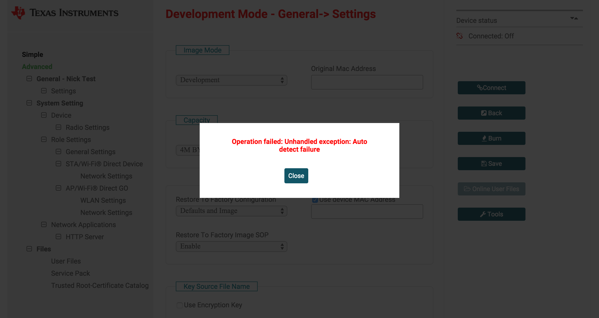

I made an attempt to possibly update the firmware via UniFlash.  I have it installed on Mac OSX and it gives me the following error when attempting to Connect.
So far, I'm really close from getting this to get things to push to the device, but having difficulties connecting to this device.  I'm using a Mac, but it seems even via UniFlash I can't connect.

    Yes, it seems like your computer is having trouble communicating with the XDS110 that is built into the LaunchPad. UniFlash ImageCreator uses the XDS110 behind the scenes for programming the CC3220x devices, so both failures probably have the same root cause.
    What we will probably need is to get the firmware version of the XDS110 on the board updated. This will be through a different utility (not UniFlash). There are some instructions here:
