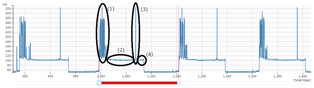

The sample program sends 24KB TCP traffic every 0.16s using sl_Send API.
This figure is the current graph captured by ITEMER-BOOST.
(1) shows transmission the TCP traffic.
(2) After transmission completed, the module continues RX about 50ms.
(3) Then TX about 0.5ms.
(4) Finally, RX about 15ms.
(2)...(4) cause increase current consumption.
I have some questions.
What are (2)...(4)?
Why the NWP does not go back idle state immediately after (1)?
Target: CC3220MODSF custom board
SDK: simplelink_cc32xx_sdk_2_10_00_04

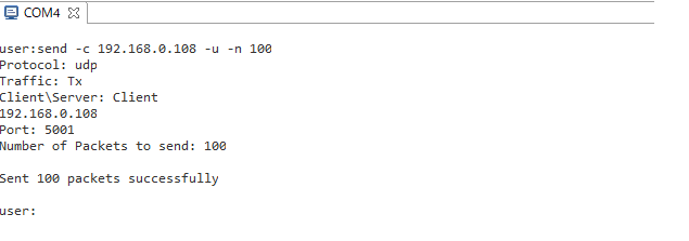

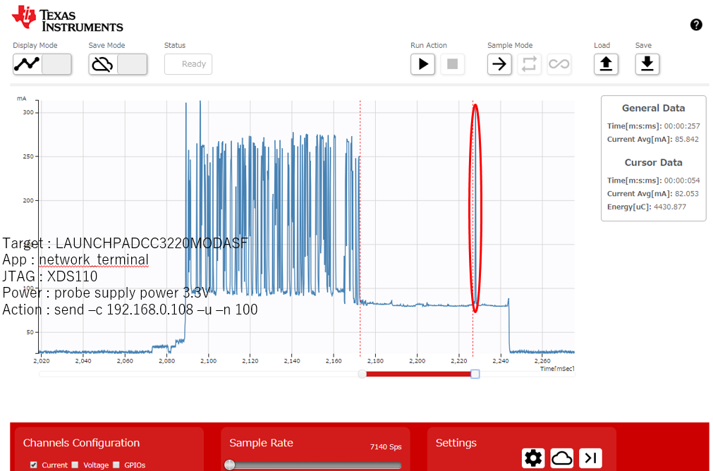

  • Hello Alexis,
    Thanks for your quick response.
    The spike also appears by network_terminal_CC3220SF_LAUNCHXL_tirtos_ccs demo app.
    This picture shows the current graph when act "send -c IP address -u -n 100" in the app.
    Nobuhiro

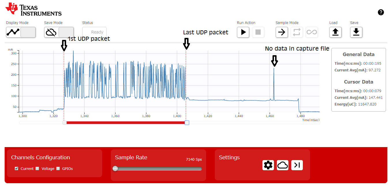

    In order to reproduce this issue the most simple way is using "send -c address -u -n 100" command on network_terminal app, I think.
    Even though the transmission has finished, the current continues for 50-60ms.
    Is this normal behavior?
    In your site, does current consumption fall down to base level immediately?
    In our app, TX happens every 160ms, this trail current consumes many energy.
    This issue occurs even with SDK 2.20.
    Nobuhiro

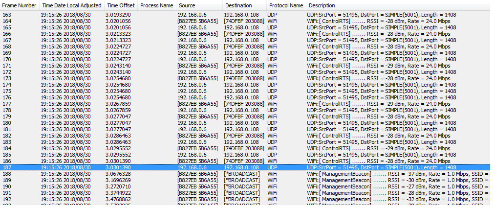

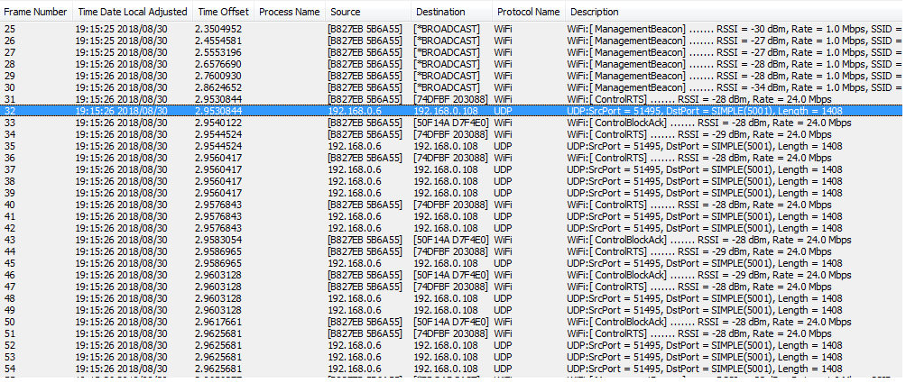

  • Hello Alexis,
    I got the current data and Wi-Fi packet capture data at the same time.
    Action: send -c 192.168.0.108 -u -n 100 (network_terminal app)
    Below is packet capture result when TX started.
    Below is packet capture result when TX finished.
    Frame no. Time offset Description
    32             2.9530844  1st UDP packet
    187           3.0301390  Last(100th) UDP packet
    Tail spike in the IMETER screenshot does not appear in the packet capture file.
    Condition
    LAUNCH-CC3220MODASF, CCS 8.1.0, SDK 2.20, network_terminal_CC3220SF_tirtos_ccs
    Nobuhiro
  • Hello Nobuhiro,
    My apologies for the delayed response. I have recreated the behavior here on my end and after reviewing your packet captures and running a few tests, I believe I I understand what is happening.
    It appears that this behavior occurs in power policies that allow the NWP to go sleep. The spike seems to appear right before the device transitions to a lower power mode. I will speak with our R&D guys and see if they can give me more definitive information.
    Alexis
  • Nobuhiro,
    As it turns out, the CC3220 sends a null data packet to notify the AP that it is going into 802.11 power save. That is what the spike is.
    Thanks for your patience,
    Alexis
