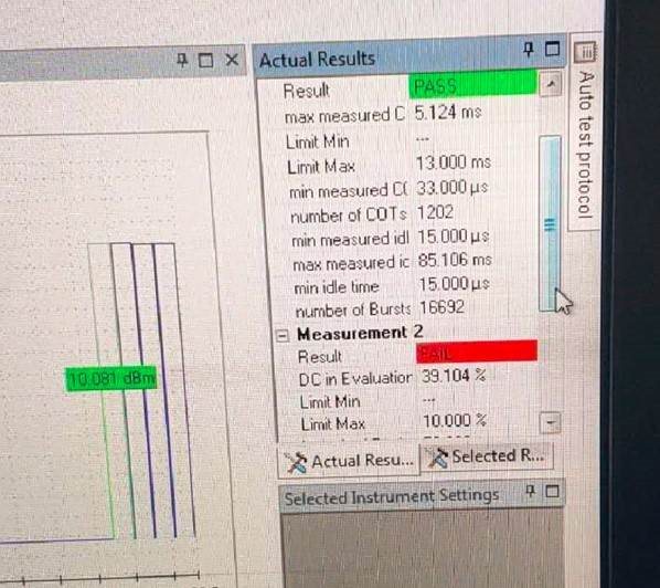

Hello TI.
  Any guider documents for us to pass EN 300 328 2.2.2  RF output power and adaptivity.
  Let me know if any information is necessary.Thanks!

  • Hi Clark,
    Are you testing the WL1835MOD module or the WL18xx chip down design? Have you modified the .ini file (reference)? If yes, please share your .ini file.
    Vihang
  • Hi Vihang,
          Thanks for your kind and fast reply,  We have not modified ini file yet,  we would like to check and re-certificate and feedback soon.
    I appreciate!
    BR!
  • Hi Vihang,
    Could you help to confirm how to implement ini file ?
    I refernce to WiLink™ 8 Solutions WiLink8 - wlconf .pdf and config as follows, Any else we should do for ini?
    wlconf -o /lib/firmware/ti-connectivity/wl18xx-conf.bin -I /usr/sbin/wlconf/official_inis/my_ini_file.ini
  • Yes, that is the way to generate the bin file.. Make, sure your ini file has all the needed configuration.
  • Hello Hari,
       I appreciate to your kind help, Recently we using follows ini file that modified EIRP form 7 to 11 dbm (reference to TI certification), but it also failed.
      1, DC in Evaluatior :26%~39% if ini file set EIRP to 11dbm.
      2, certification authority require EIRP >10 dbm  to pass this case.
    -----------------failed detail-------------------------------

    Can you please help me understand what you mean by " modified EIRP form 7 to 11 dbm (reference to TI certification), but it also failed"
    and "certification authority require EIRP >10 dbm to pass this case."
    There should be no need to modify the .INI file when using the TI module. If you do change the .INI file this violates the modular reuse as you will change the radio settings and can potentially cause other issue , thus requiring re-certification.
    There is no requirement that the EIRP be > 10dBm. The requirement is when the output EIRP power is greater than 10dB then you require adaptivity.
    Note that EIRP power includes the antenna gain. The first think to ensure is that you pass adaptivity. Did you pass this? This requires you to be running in application with iperf and connected to an AP. This should be done conducted and the system calibrated such that the power to the DUT is the calibration plane. Also the AP should be set up for a single test frequency and modulation so it will not change during the test.
    For the interferer signal it is required to be 100% duty cycle (not 99%) or you will fail the test). Can you please confirm that you pass adaptivity for your design?

  • Hi Riz,
    Thanks for your reply.
    1, Adaptivity certification should be tested with EIRP >10dBm, and we could not find right way to set up.
    2, Certification authority tested 'Adaptivity' follow your explaination, including duty cycle, iperf, single test frequency etc.
    3,We had passed Adaptivity testing with default TI 's certification ini file, but EIRP is 7.222dBm.
    4,Certification authority and states of product do not allow us to modify antenna gain by hardware. So we try to set EIRP by iw,wlconf,ini etc
       Could you help to  advice what could we set EIRP to pass Adaptivity testing under wireless only station mode?
    I appreciate!

  • Hi Riz,
            1, We used TI's certification ini file to measure  802.11n,and  channel is 2472Mhz, the output power is 7.222dbm.
            2, CE out powers had tested ok by RTTT tools.
            3, We did not use antenna, Test device will detect ANT.(PS: set +3dbm gain)
           Update information:
           We had passed 2472MHz adaptivity test  when changing AP sending data to local deivce. but not used iperf.
           But, We could not pass adaptivity  in 5G.  I will upload more detials soon
           Thanks for your kind help.
    BR!
  • Hi Riz,
              Update status of Wifi certification.
    1. We had passed 2.4G Adaptivity test yesterday.
         (Using TI certification ini file,  AP send data to local device(station) but not iperf. That could be passable to Antenna power)
    2. 5G Adaptivity test failed , using 2.4G 's same test case except modified ini file to enable 5G.
        The failed reason is :DC in Evaluatior  > 5%
        modulation: 802.11n,  channel 36
        Q: How could I set config to stop resend data that seems like reconnected or sniffer to reduce DC in Evaluatior?
             (PS: AP set fixed channel 36, other channel is not available.)
        more detials:
        [How and what we test for certification adaptivity]
    [Channel 36 status,  100% duty cycle interferer signal action on]
    That 's all, Thx.
