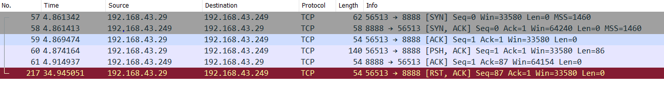

I have a working product where I sometime use the proxy and http to debug it.
Now I have a customer who wants to use their proxy to connect to our server over https.
Is this supported with the Http client?
I have been able to connect to the server with HTTP using either the customer proxy or Fiddler on my computer.  When I configure the https connection (which works OK without proxy), I get the error -462 (connection timed out due to handshake time)
Wireshark shows that it's the CC3220 which stops the connection and resets it after 30sec. See screenshot.

    When checking the code of httpcli.c, I do not find any place where the HTTP CONNECT to the proxy is triggered. There is the function httpProxyTunnel which does what I would expect, but it's only included for non simplelink platform. Am I missing something?
