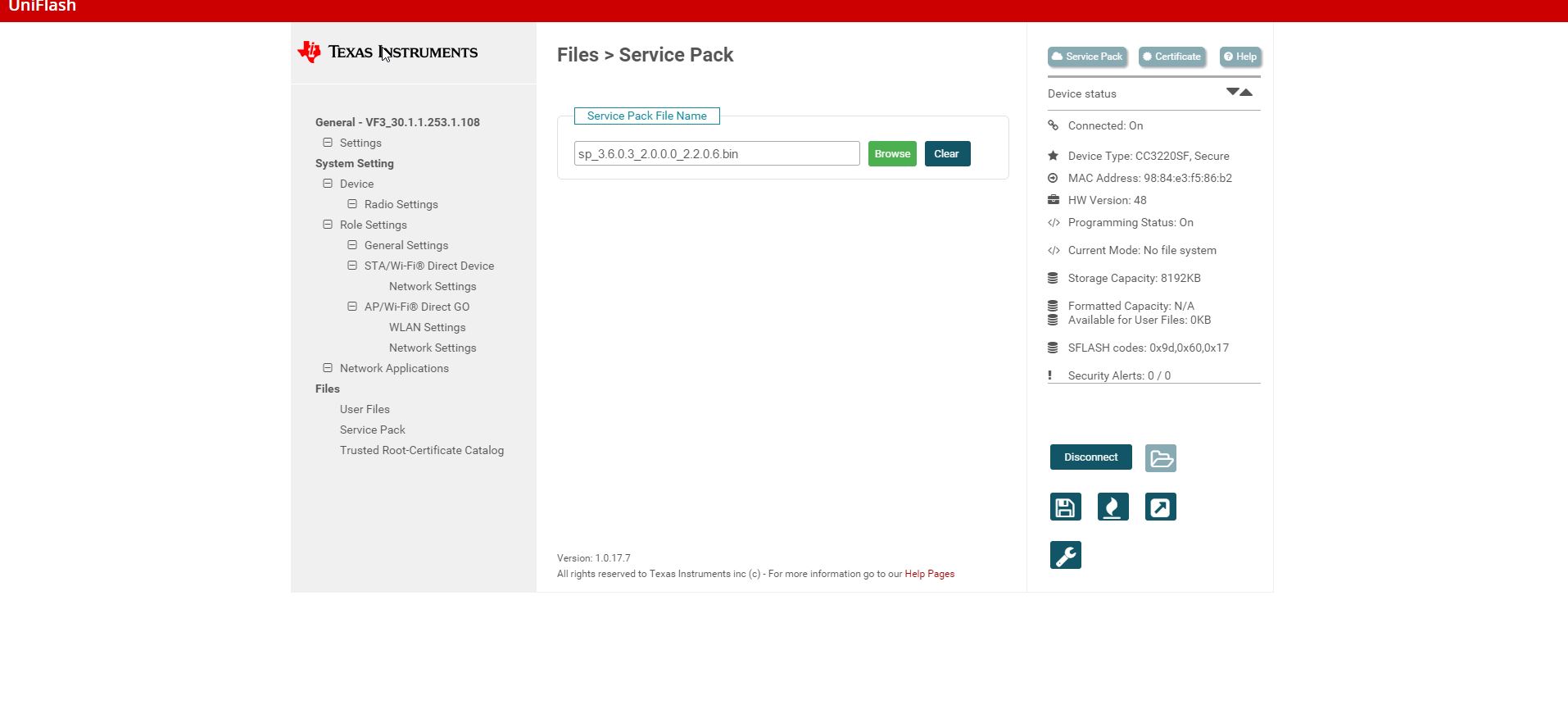

Hello ,

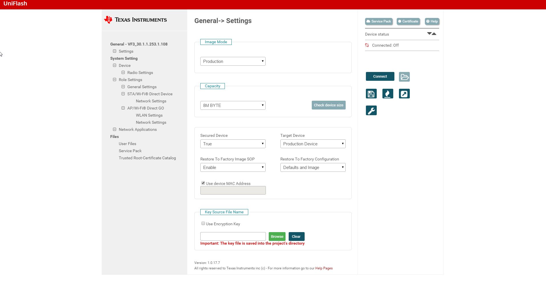

I`m trying to Program Image on a Board using Uniflash + GoDaddy certificate.
But for Some reason i get the error below
My Settings as Below
Please advice if i`m doing this wrong .
  • Hello Yonnatan,
    You need the entire chain of trust (set of certificates from which this certificate is derived) that was issued to you to be added to the file system and they need to be in .der or .pem format. You can convert your .cer file using OpenSSL.
    If you take for example the trusted chain in the playground directory, you need:
    dummy-trusted-cert with "issued by" pointing to dummy-trusted-ca-cert
    dummy-trusted-ca-cert with "issued by" pointing to dummy-root-ca-cert
    dummy-root-ca-cert with "issued by" to dummy-root-ca-cert (self signed as it is a root CA)
