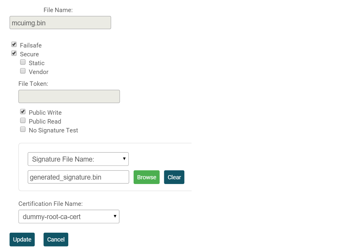

  • Hi Jan:
          How could i config the Fw-B about the certification and signature?
    Because you load this file (Fw-B) by yourself, you do not deal with that. Certificate and signature is important only for your Fw-A (which is loaded by ROM bootlaoder).
    Jan

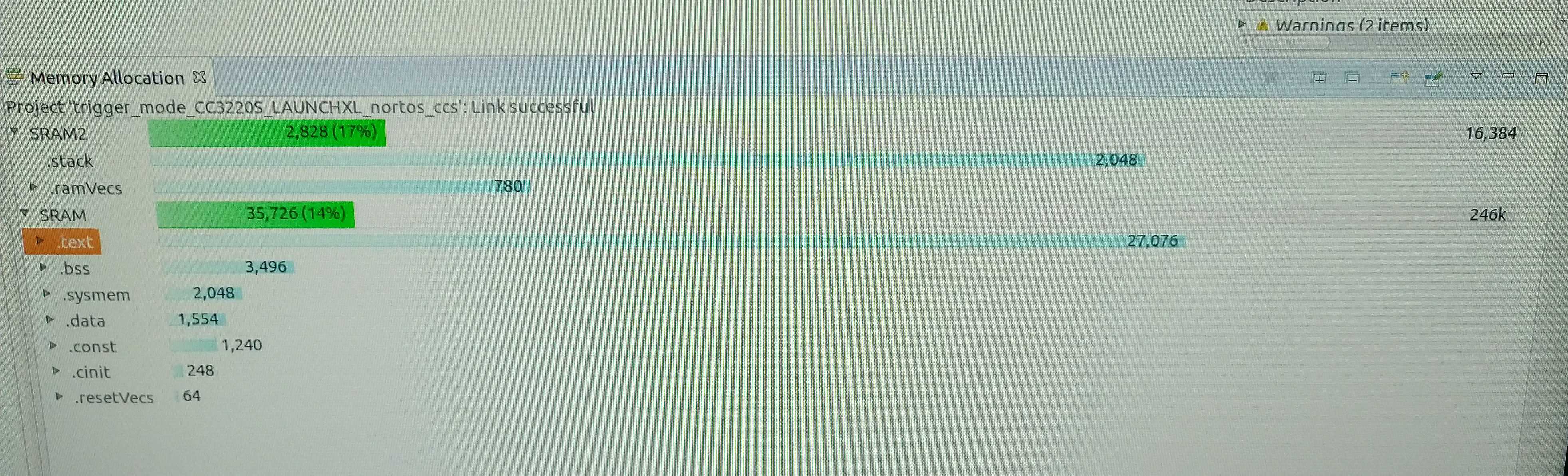

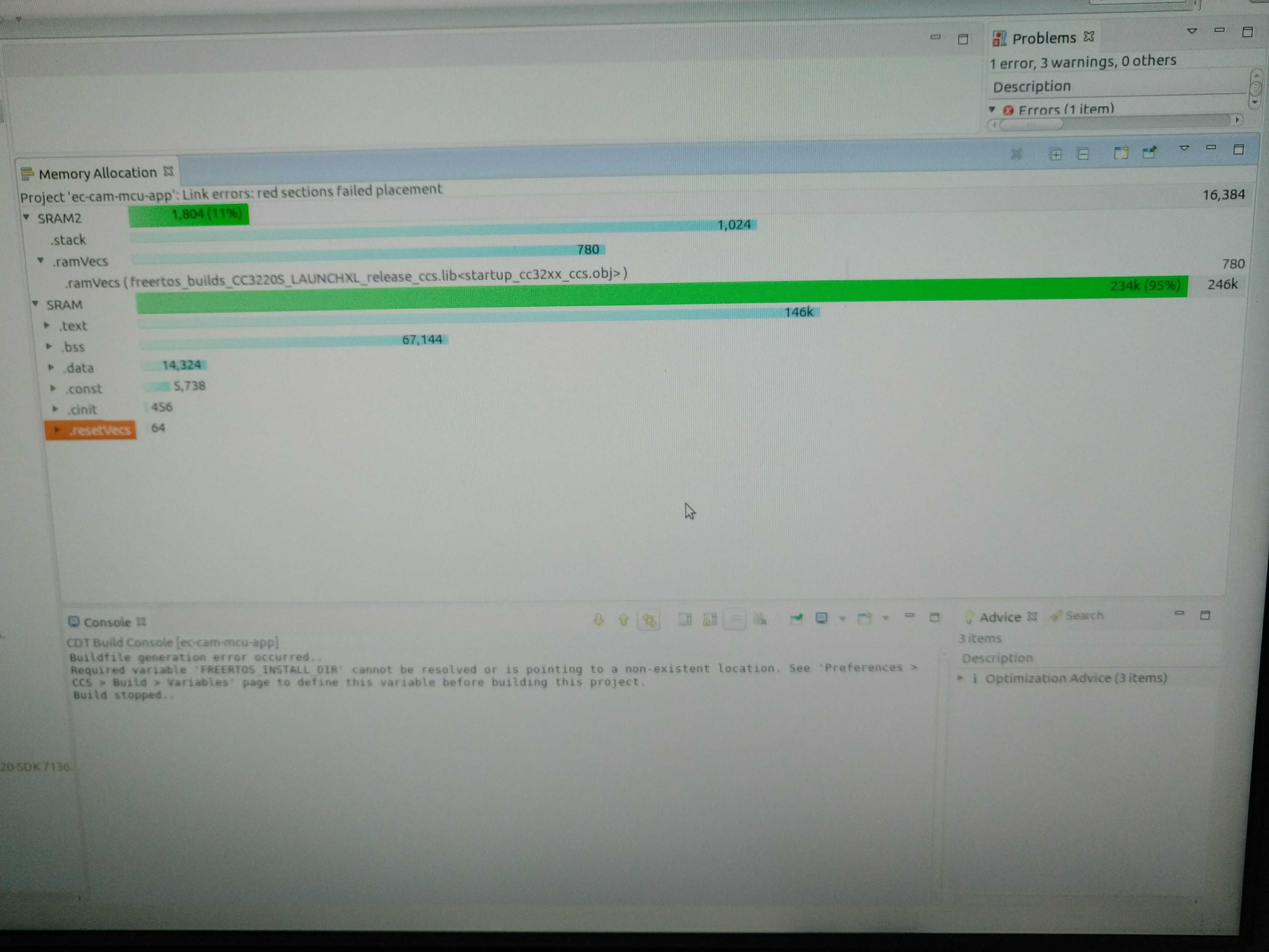

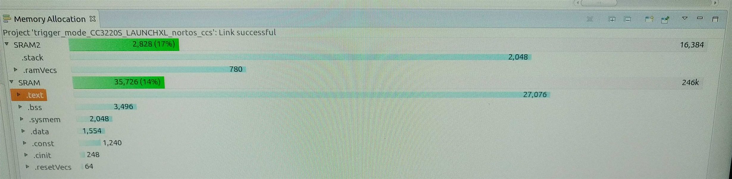

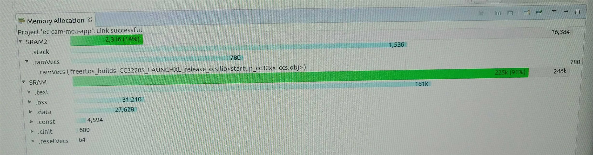

  • Hi Jon,
    Can you provide here output from Memory allocation tool from CCS (I am to lazy to count it from memory map :))?
    ... I could give you advice how to map your RAM for apps. and bootlaoder.
    Jan

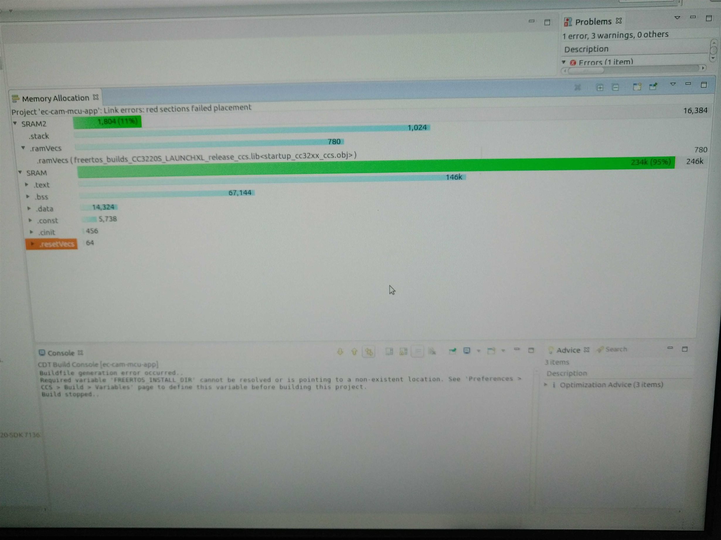

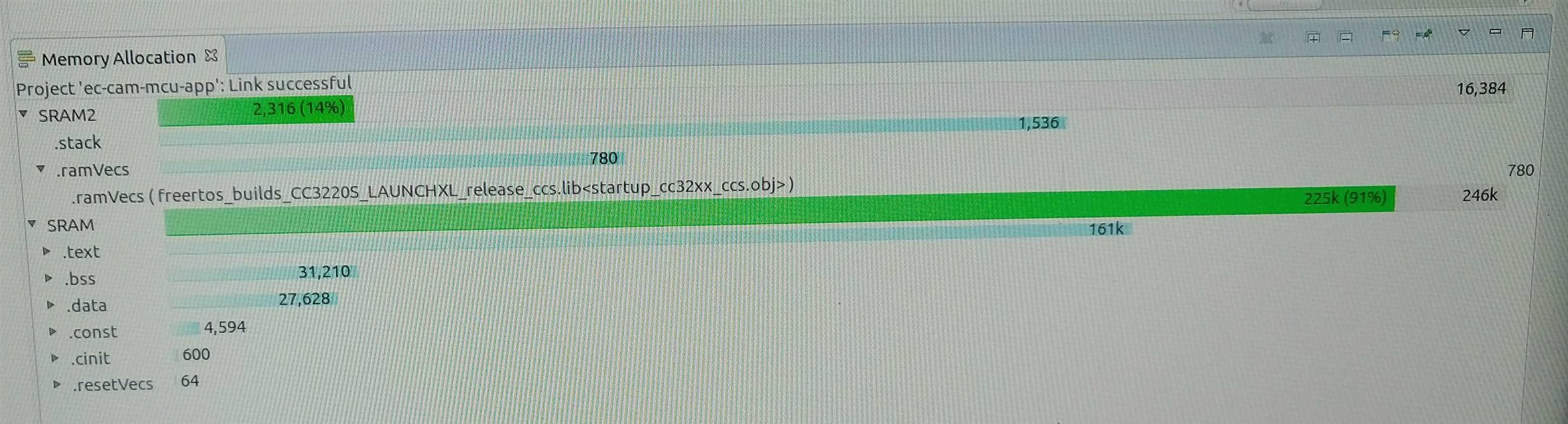

  • Hi Jan:
     Fw-A:
    Fw-B(Factory test):
    Bootloader:
    Jon

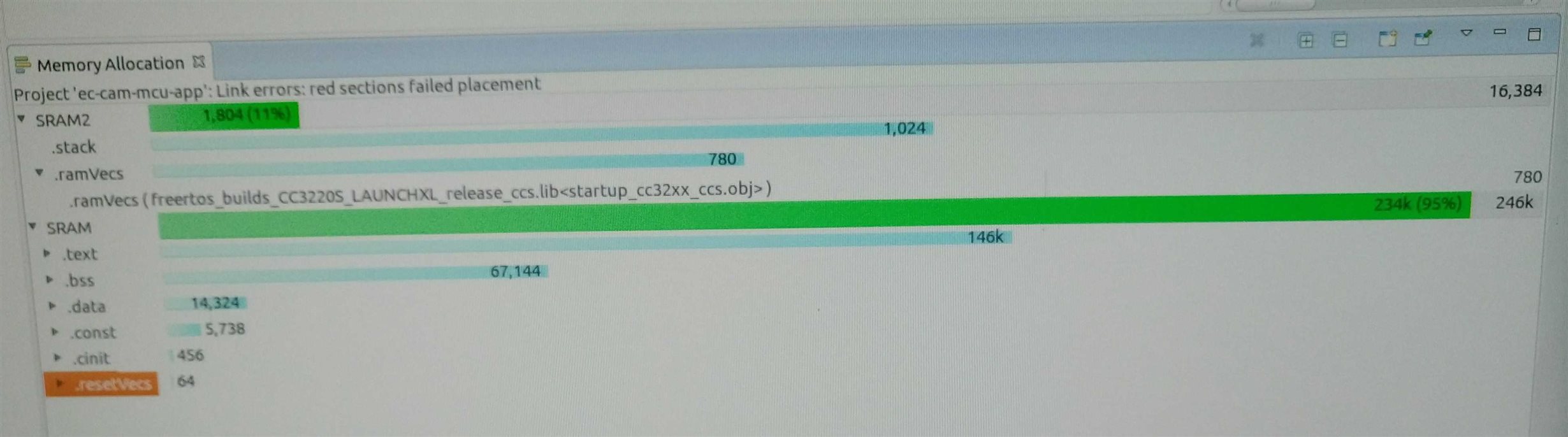

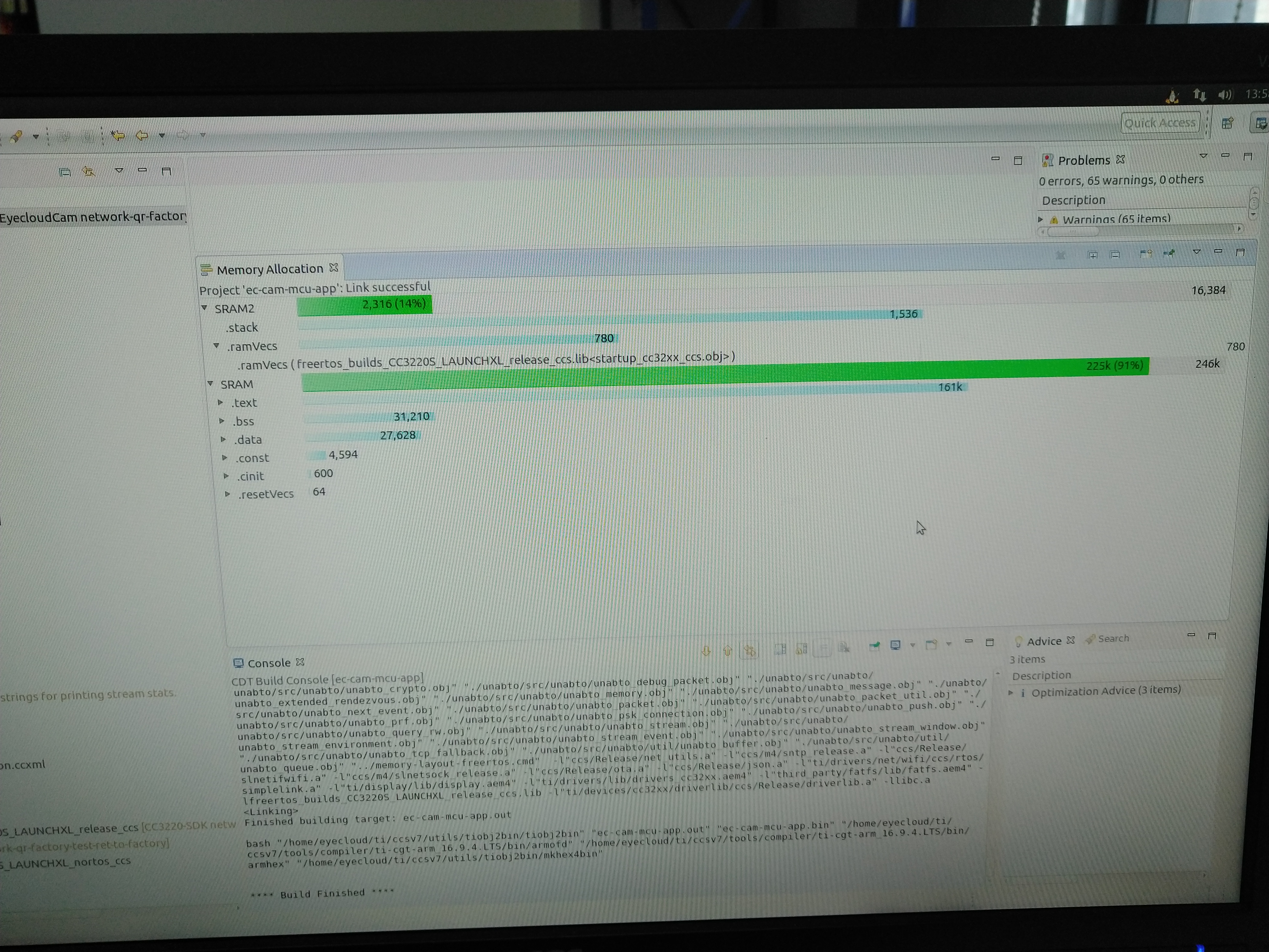

  • Hi Jan:
     Fw-A:
    Fw-B(Factory test):
    Bootloader:
    jon
  • Hi Jon,
    Linker file for Fw-A and Fw-B could look like:
    #define SRAM_BASE 0x20013000  /* your application starts at this address */
    MEMORY
        SRAM_DATA (RWX) : origin = 0x20000000, length = 0x13000  /* 76kB for RAM stuff */
        SRAM_CODE (RWX) : origin = 0x20013000, length = 0x2D000  /* 180kB for code in RAM */
    SECTIONS
        .text       : > SRAM_CODE
        .TI.ramfunc : > SRAM_CODE
        .const      : > SRAM_CODE
        .cinit      : > SRAM_CODE
        .pinit      : > SRAM_CODE
        .init_array : > SRAM_CODE
        .data       : > SRAM_DATA
        .bss        : > SRAM_DATA
        .sysmem     : > SRAM_DATA
        .stack      : > SRAM_DATA(HIGH)
        /* these sections are used by FreeRTOS */
        .resetVecs  : > SRAM_BASE
        .ramVecs    : > SRAM_DATA, type=NOLOAD
    Linker file for boorloader:
    #define RAM_BASE 0x20004000
    MEMORY
        SRAM_CODE (RWX) : origin = 0x20004000, length = 0x8000
        SRAM_DATA (RWX) : origin = 0x20000000, length = 0x4000
    /* Section allocation in memory */
    SECTIONS
        .intvecs:   > RAM_BASE
        .vtable :   > SRAM_CODE
        .text   :   > SRAM_CODE
        .data   :   > SRAM_DATA
        .bss    :   > SRAM_DATA
    ... bootlaoder will read content of file in sFlash and upload it to RAM beginning from 0x20013000 and execute it. I did not tested this linker files and I missed something maybe. But it illustrate how can be changed linker file to be used with bootloader and save some valuable RAM space.

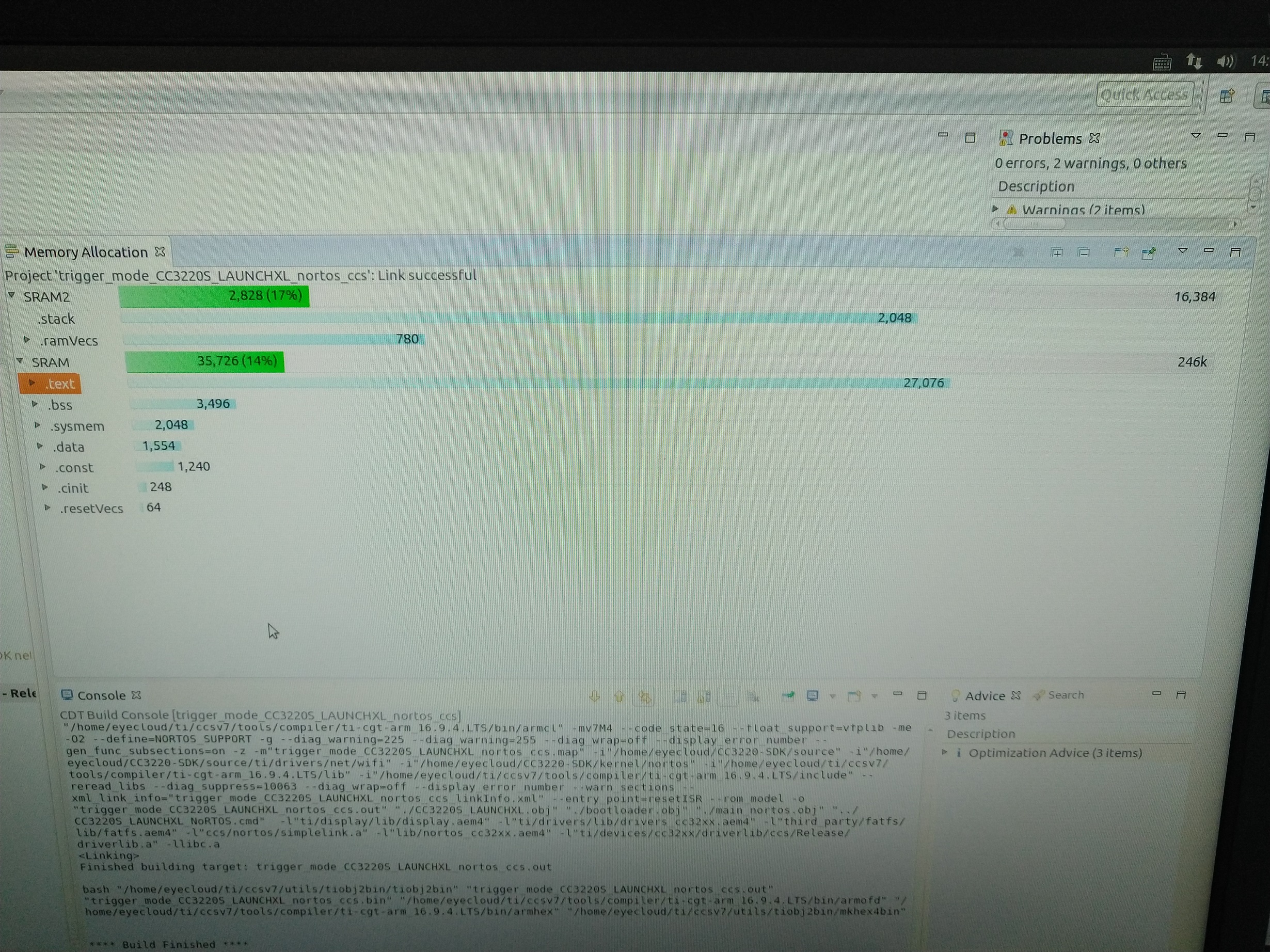

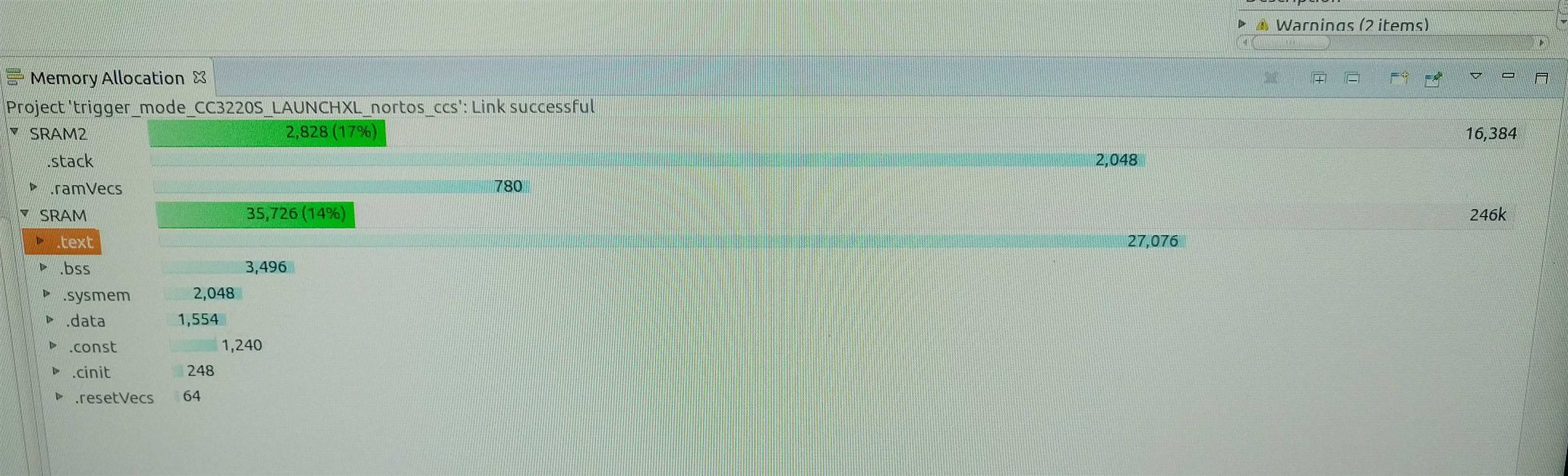

  • Hi Jan:
    Bootloader:
    Fw-A:
    Fw-B(Factory test):
         Also,another question,if i want to put a bootmode.bin file under the root filesystem packet,when the bootloader find this 'bootmode.bin' file,it will load the Fw-B to the RAM. And after factory testing,the 'bootmode.bin' will be deleted by the Fw-B. I know there is a initialize image packet concept,would the 'bootmode.bin' file be recovered when i do the restore the initial state operation?
    Jon
  • Hi Jon,
    In case of 'bootmode.bin' will be part of factory image and factory restore feature will be used, file 'bootmode.bin will be restored. If this behaviour is not intended, you should consider to add feature to create this file in Fw-A.
