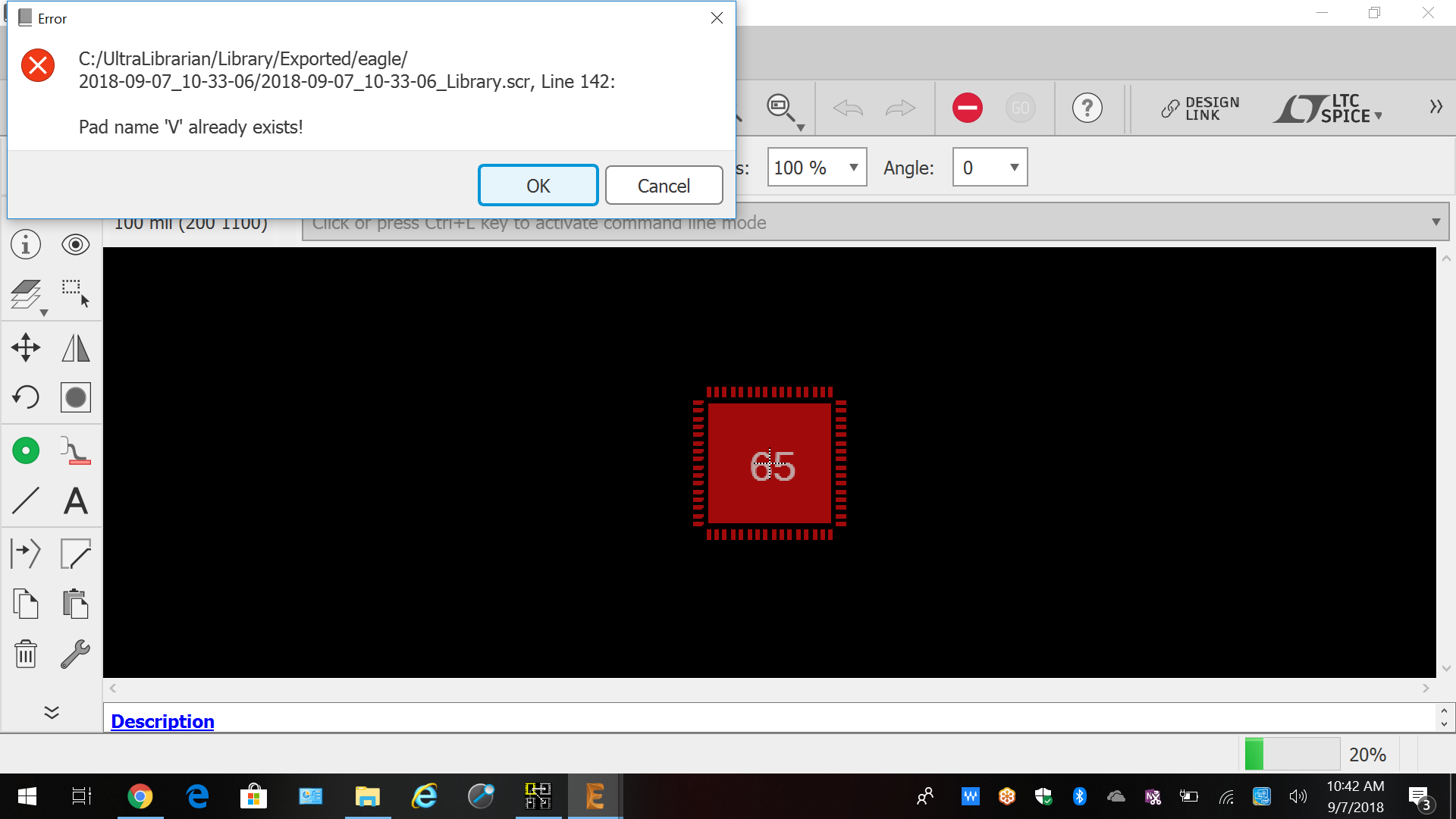

hello,
I was looking for eagle library for cc3100 boost , can anybody help me?
- Design files for CC3100BOOST are created at Allegro PCB Designer ( www.ti.com/.../swrc288 ). According this discussion ( forums.autodesk.com/.../6859348 )it looks that Eagle does not supports import files from Allegro PCB Designer.
- CAD files for CC3100 QFN and MOD you find here webench.ti.com/.../cad.cgi

Hi kary,
There are often issues when converting CAD files. After exporting, the three main parts of the design files (schematic, layout, component library) do not always map to each other correctly.
Have you tried using the offline version of Ultra Librarian? You can download it for free on TI.com: http://webench.ti.com/cad/

Kary,
Our tools team has updated the CC3100 BXL file. I know you've created your own, but just as an FYI - it's been uploaded to TI.com, and I've also attached it here: CC3100_RGC_64.bxl
