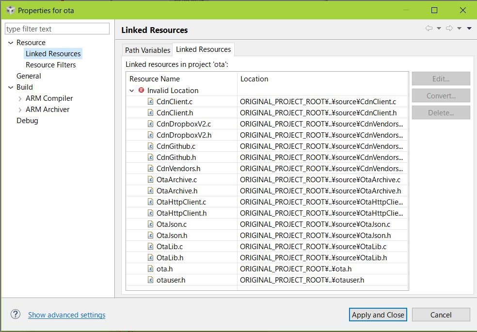

  • Hello Sarah
    thank you for your answer.
    Yes, I am following the instructions of the SimpleLink Academy OTA lab. Task 1.
    I changed the Properties of ota project according to the instructions.
    ota project Properties> Resource> Linked Resources.
    so
    "PROJECT_LOC" -> "ORIGINAL_PROJECT_ROOT"
    Was executed.
    The result was the result of the previous question.
    Attached is ota project Properties.
    Where am I wrong?
    Thank you.
  • Hi H. Wt,
    Can you change the odd symbols in your file path to a slash(/)?
    The easiest option though is to just delete the ota library from your workspace and import the library again with "Copy projects into workspace" unchecked as detailed in step 2.
    Sarah
  • Hello Sarah
    I am sorry that the reply was delayed.
    Somehow, the build of the ota library succeeded.
    After all, I did not succeed in the way I recommended in my project.
    I changed the parameters and executed it as follows.
    ota project Properties> Resource> Path Variables
    New Add
    Location: "C:\ti\simplelink_cc32xx_sdk_2_20_00_10\source\ti\net\ota\ccs"
    cloud_ota project Properties> Build > ARM Linker > File Search Path > Include library file... and change the ota.a reference to
    "C:\ti\simplelink_cc32xx_sdk_2_20_00_10\source\ti\net\ota\ccs\Release\ota.a"
    Now the build of cloud_ota succeeded.
