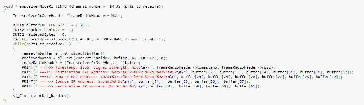

I want to use the CC3220 to query the MAC addresses of all the devices within range. Is this possible? If so, is there example code to do this?
Further, I'd like to see the source and destination IP address of all WiFi packets. Is that possible too?
