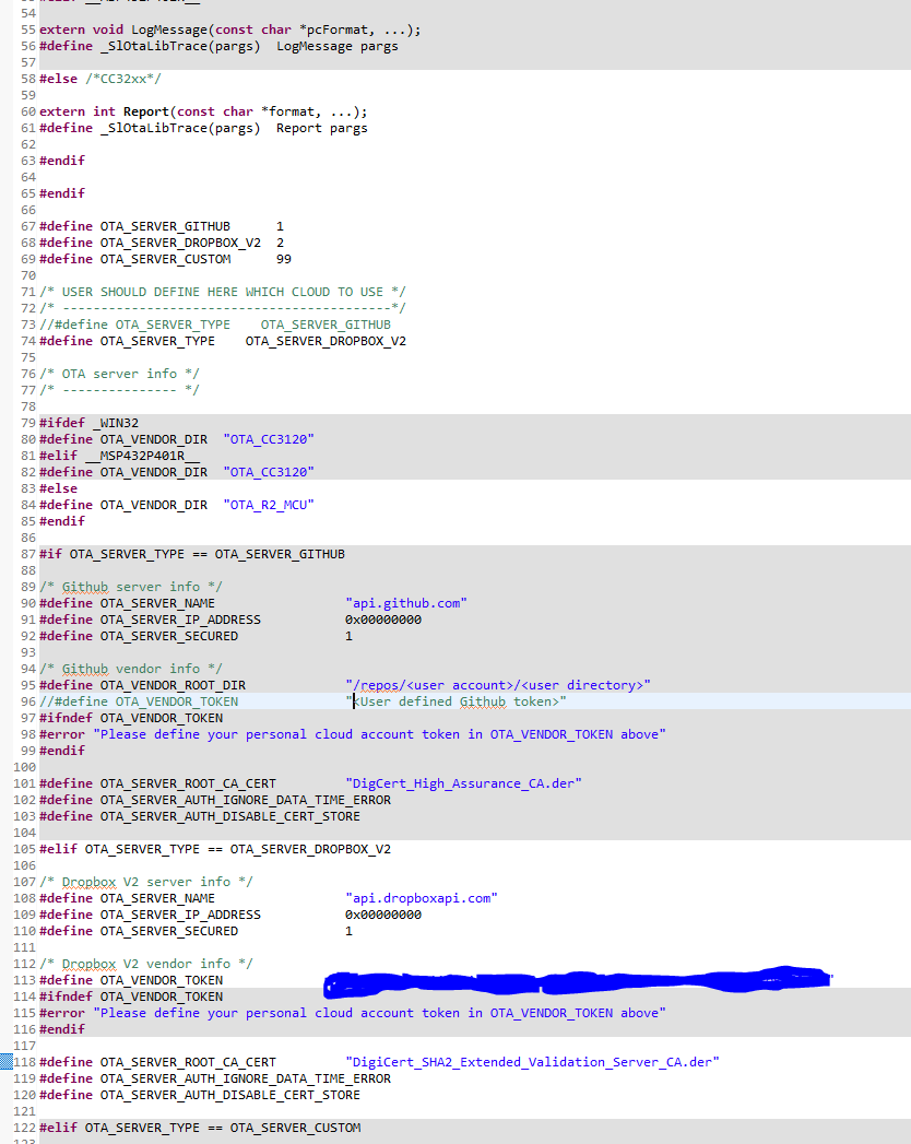

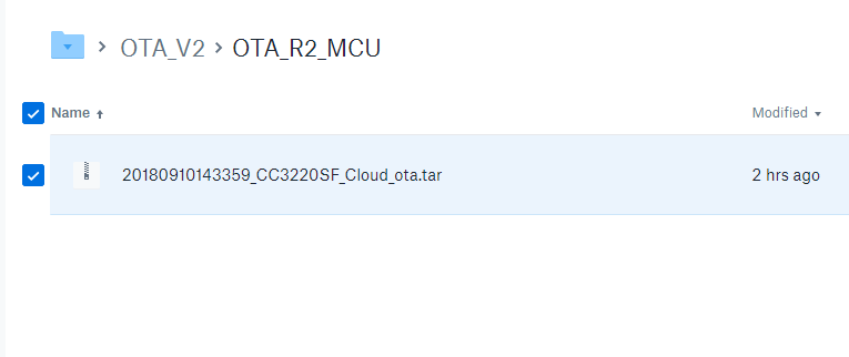

- The document uses the repository name as OTA_V2 but in otauser.h it uses #define OTA_VENDOR_DIR  "OTA_V2_MCU" :
Does it means if i use xxxx as a api name, do i have to use xxxx_MCU name for the ota vendor dir?
- After that, is all my need is changing ota vendor token and build the gmake.exe file and build the project? I think it is not all secured for the internet and dropbox connection, for example how can this demo example takes the https certification, date and time etc. I cannot see this parts when i was checking the code, so it seems a little mixed.

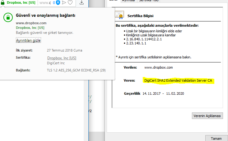

  • Thanks Sarah, today i resolved naming issue but i have still problems about connecting. I have the same error code(OTA_RUN_STATUS_CONTINUE_WARNING_FAILED_CONNECT_FILE_SERVER (+20006L)), and for example i have tried this code snipped given in OTA Lab, sent below, and i had no error on uart .
    I think there is a SSL, TLS connection issue. All configurations are like the documents said now. Maybe you can check my configs if i send screenshots?
    Thanks!

    And thats why i used "DigiCert_SHA2_Extended_Validation_Server_CA.der" file, i downloaded it using this information:

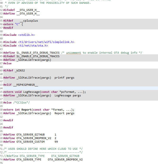

    Can you define SL_ENABLE_OTA_DEBUG_TRACES in your otauser.h? It should be commented out. Then rebuild your library and application.
    Sarah
  • Hi Sarah,
    It is not commented out. Maybe there is a problem in gmake.exe compiling if you say it looks like commented out?

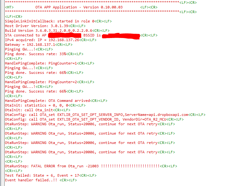

  • Hi taylanb,
    Josh was referring to the dummy certificate that can be used for testing OTA. In the SimpleLink Academy OTA lab, this is what you flash to your device to load the pre-built image in task 3 and how you sign your own OTA image in task 4. You cannot go into production with this certificate, but this does not affect your demo testing.
    With the debug trace enabled, I expect more terminal output, especially from OTA_init since you are getting past that function. Can you verify that you are linking to the correct build of the OTA library in your workspace from your example project properties?
    If you haven't already, please try increasing the MAX_METADATA_FILENAME definition from task 1 step 4.
    Sarah

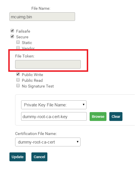

    -10365 is a file system error SL_ERROR_FS_INVALID_TOKEN_SECURITY_ALERT which looks like you're trying to open a file without providing the token.
    1) Did you sign your mcuimage.bin or any user files in your OTA image with a file token? It would be this parameter in ImageCreator:
    2) Did you sign the OTA image as shown in task 4 step 5?
    3) Did tasks 1-3 work for you with the pre-built OTA image on the provided GitHub?
