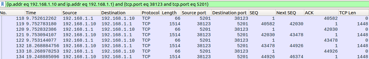

I've done packet captures from both sides while running iperf3 and I frequently see things like this:
The capture below was taken on the board with WL1837MODGIMOC. Notice the huge time gap between packets 122 and 132 in this TCP conversation.
This next capture was taken on a rooted SM-T580 at the same time. Notice how it's trying to send the same packet a few times until it finally happens at the 18 second mark.

    Notice the retransmissions sent from Android (192.168.1.10) which happen between packets 419 and 603, trying to resend packet 404. I don't understand why these packets are not being received.
