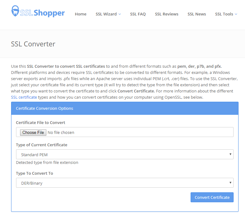

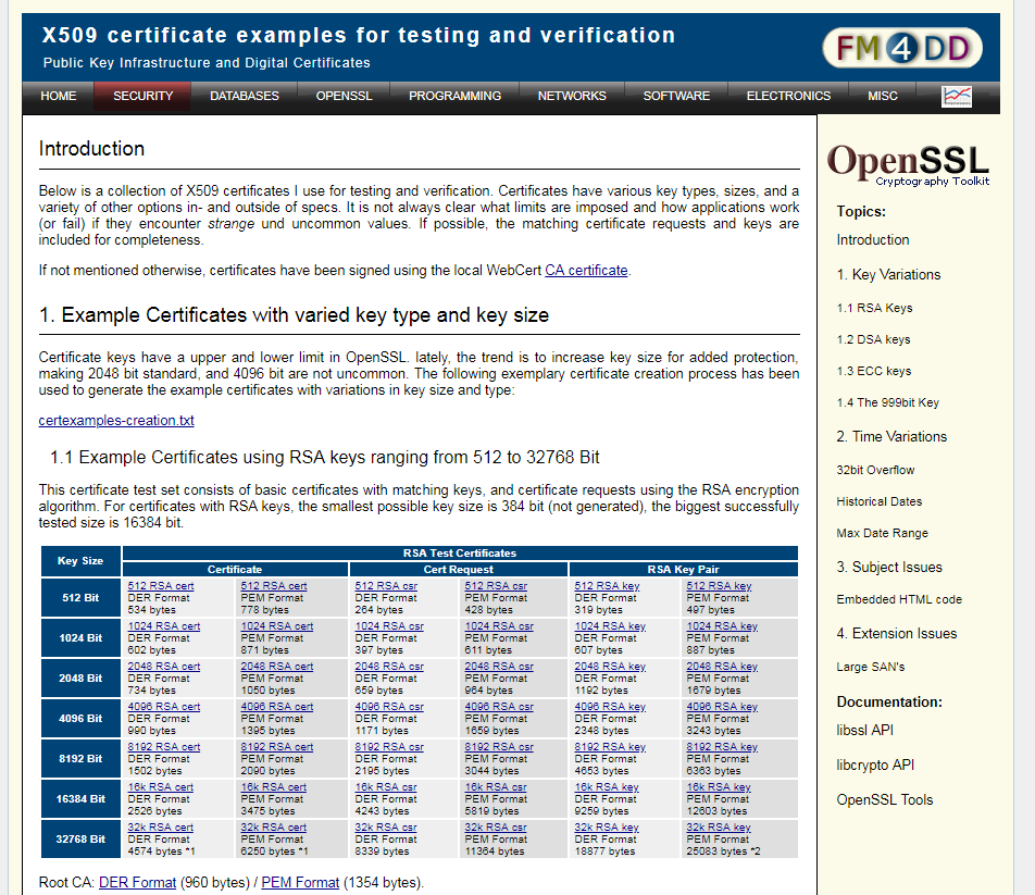

The Vigor Device can generate it's own certificate, which I have done based on RSA 1024bit key size.  This generates a certificate in .pem format.

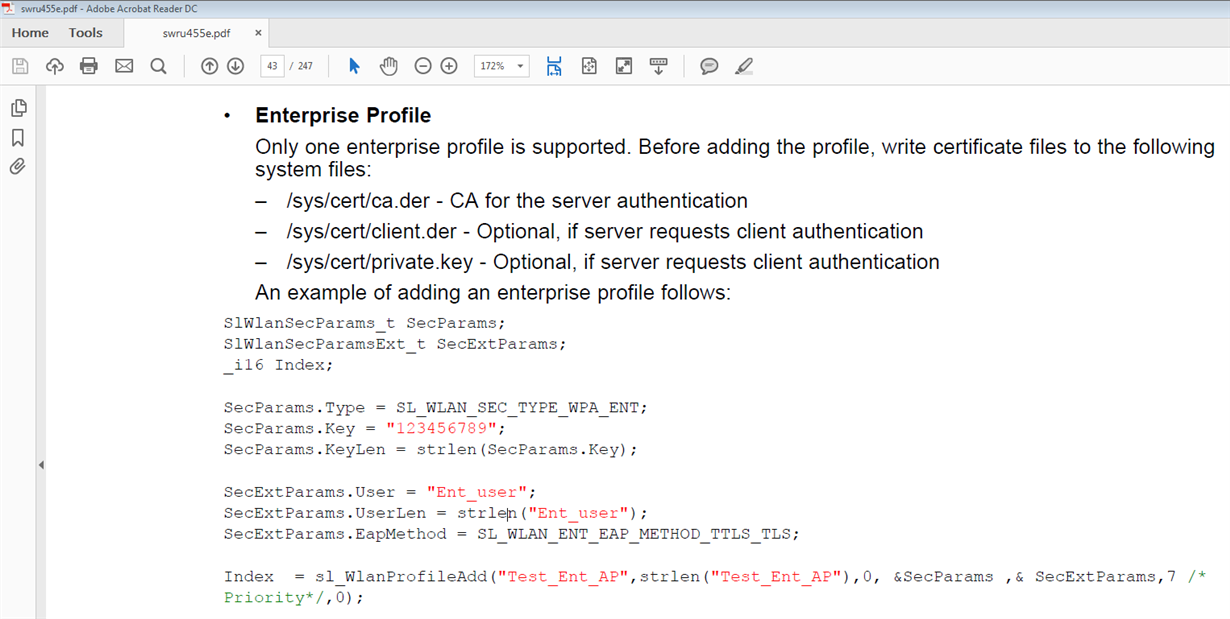

In document SWRU455e, it states to write certificate files to the following locations.
now, I only have 1 certifcate file, so this goes in /sys/cert/ca.dev
The question is will the AT Command interface allow the writing of this file via the AT command interface.

It looks like I need to provide a certifcate, a user name and a KEY.  I think the key is available on the draytek if you give the client an IP address,
