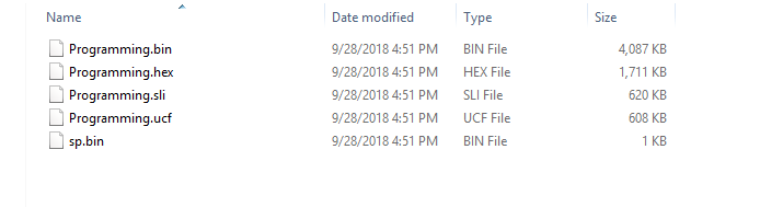

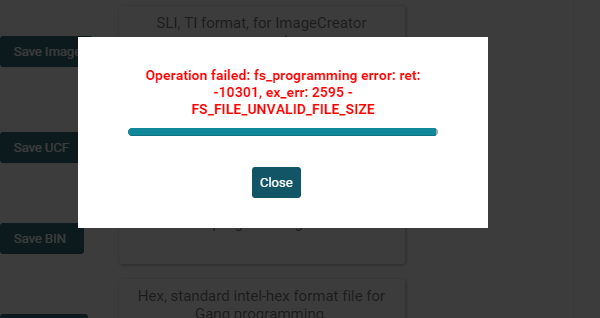

      I am trying to dump code but i am getting error
      i am using CC3220SF-LAUNCHXL board here 32mb flash is there why i am getting error ?
      when i add web page(css,images,js,html) code that time showing error ?
     any size limit is there ?
     How to solve this issue ?
Thank you
  Vasu
  • Hi Vasu,
    At CC3220 LaunchPad is integrated 32Mbit flash (that mean 4MB not 32MB). How big are all your files?

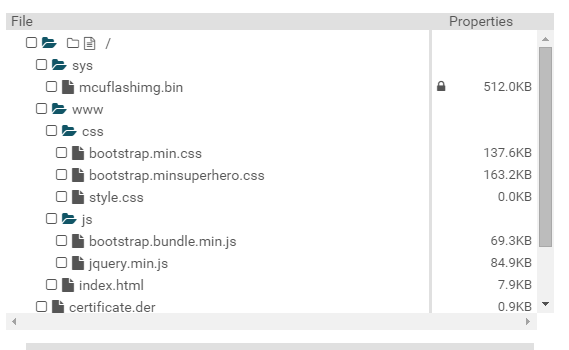

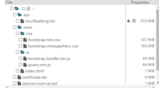

  • Hi Vasu,
    Your web files have approximately 500 kB. This is not that big I was afraid, but still far to ideal size. Issue is that you have a few big files and this is not a best practice for embedded device. At load time all your files (0.5MB) need to be transferred to client and this can take a while. Better is to have slitted web-pages to more smaller parts and dynamically load it when is needed. This approach dramatically improve user experience. You should consider to change architecture of your webpages.
    But I think you have somewhere bottleneck. You need investigate where is.

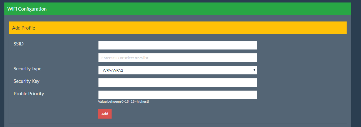

  • Hi Jan
    Thank you for your reply,
                 Now i am  simply developed wifi configuration page . timing being i am not handle  SimpleLinkNetAppRequestEventHandler.
                 directly using token name for configure wifi.
                 Now i am planning to remove big files.

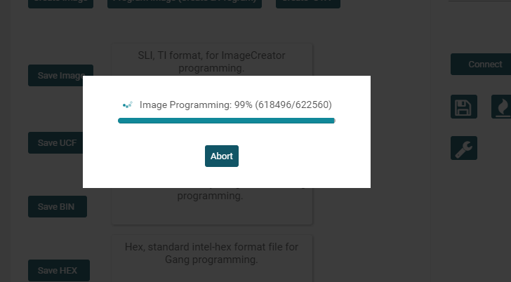

  • Hi Jan
    Another issue
      Previously dumped but now error on same file why ?
         Compare to OOB uniflash example this small size why i getting error on dumping ?

  • Hi Vasu,
    - Maximum size of the single file in filesystem is unlimited, but it need to fit into sFlash. sFlash also contains many other files including ServicePack and system files. Available free space in flash is lower in case of restore to factory feature is enabled (see chapter 7.15 in SWRU455).
    - similar web pages cannot have more than 10kB including CSS. You have 500kB, that is really overkill.

  • Hi Vasu,
    - Yes, you can use 200k or 300k webpages, but smaller are better. I was only surprised that that simple webpage have 500kB with styles because this is big wasting of the resources.
