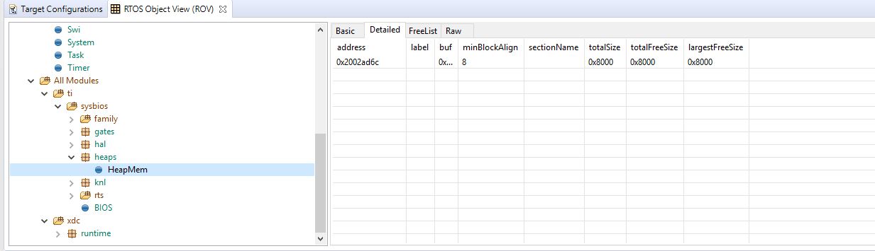

    Now my next step is to understand WHY it is failing and I am following the ROV. Below is the screenshot of heapMem:
    I am not sure but from what it shows it seems like there is no problem. Can you confirm?
    David
  • Hi David,
    Your screenshot shows no problems. However, this is probably because you haven't started the program yet. If you run your program, and then pause execution when you get to rc = pClient->networkStack.connect(&(pClient->networkStack), NULL) through a breakpoint, what do you see in the heapmem and task detailed views?
    Michael

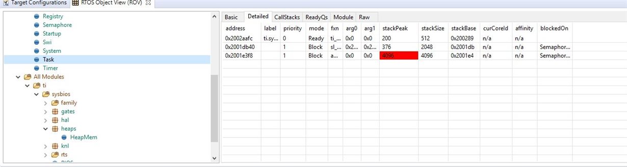

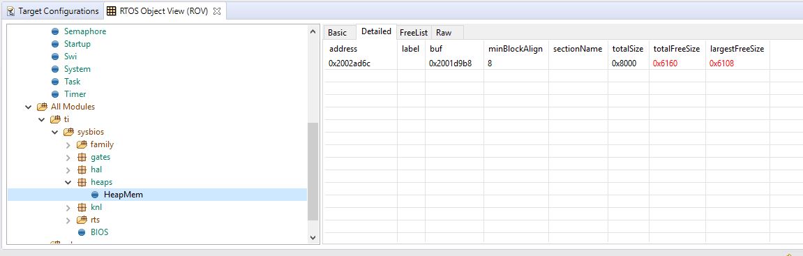

  • Hi Michael,
    My current test is running on original example with TX/RX changed to 1024. No additonal structs. For this, the program is stuck in the while loop in Hwi_excHandler (Hwi.c):
     *  ======== Hwi_excHandler ========
    Void Hwi_excHandler(UInt *excStack, UInt lr)
        Hwi_module->excActive[0] = TRUE;
        /* spin here if no exception handler is plugged */
        while (Hwi_excHandlerFunc == NULL) {
        Hwi_excHandlerFunc(excStack, lr);
    The heapmem and task screenshots are below:
    I can see task shows red. I increased it to 8192 in main and it work. You helped very much. The same remedy worked for my main application as well.
    David
