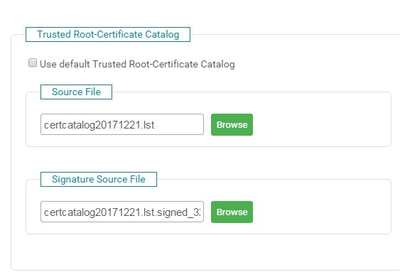

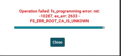

Hi Team,
  Can you please give some help about my question?  if  choosed the newest root-certiciate catalog, I will meet below issue.
  • Hi Yue,
    You need to use the source and signature files from certificate-playground folder. The ones you have shown seem to be from certificate-catalog folder.
    David

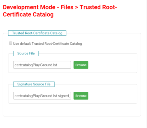

  • HI Yue,
    As David pointed out, if you are using the dummy cert chain to sign the CC3220 binary, you will need to include the dummy playground certificate catalog in Uniflash. Otherwise, the root CA of the dummy chain will not be recognized, throwing the filesystem error that you see above. Your Uniflash setup should look like this:

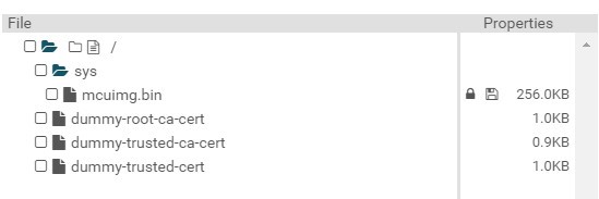

  • Thanks, actually I have got this through experiment. Just wondering why need a Root-CA list? I have alreayd added the specific Root-CA and my certificate into file system. if I used a self-signed certificate , is it ok to not include the Root-CA list?
  • Hi Yue,
    The point of the root CA catalog is so that the CC3220 can decide which root CAs it trusts. This list of trusted root CAs is comparable to similar catalogs distributed with web browsers, operating systems, etc. that allow devices or applications to use a chain of trust. Without a catalog of trusted root CAs, anyone can make a self-signed certificate and then the device would not be able to distinguish the trustworthiness of such a certificate compared to one signed by a well-known root CA.
    If you wanted to use a self-signed certificate, you will have to follow the steps provided in the vendor device authentication appnote:
    www.ti.com/.../swru547.pdf
    This involves programming the OTP region of the CC3220.
