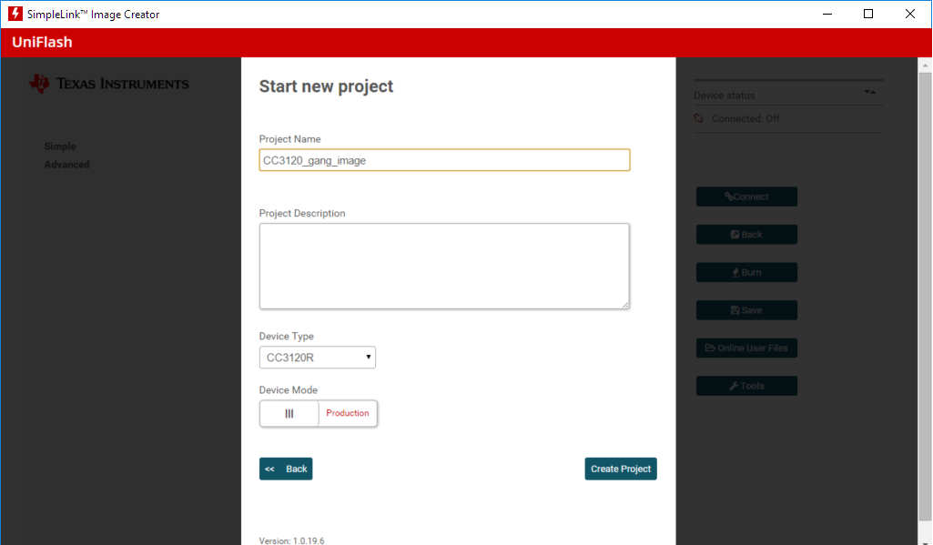

    Uniflash 4.4.0 does support creating the gang image for the CC3120. To do so, go through Uniflash and launch ImageCreator as you would for a CC3220 launchpad. However, when creating a new project simply select the CC3120R like so:
    From there, you can add the servicepack from the SDK, then click on Burn -> Create Image -> Save BIN to get the gang image needed for SPI flash programming.

    I do find the Create Image button by clicking on the Burn button and save the bin file successfully.
    Thanks for your help.
