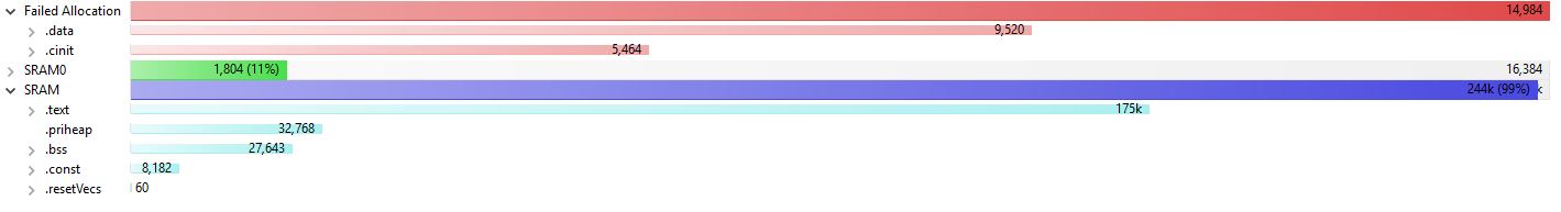

I have a tough situation with memory. Not sure what's the best approach to deal with it and where is the best place to start, so I am asking for your advice.
Below is the overall picture. The ".text" seems very big. Is it usually the case in your programs as well?
David
  • Hi David,
    Your memory requirement to CC3220S device are too big. You have have following options:
    - switch your design to CC3220SF device (recommended way)
    - optimise your code or remove some features from the code
    As start point you can try to move .data section into SRAM0 and decrease size of heap if 32kB of heap is not required by code. But I think this will not be real solution for long time. Other option can be dynamically load part of code at runtime. Example how do that you find at CC3200 SDK at example dynamic_lib_loader (it it for 1st generation of CC32xx, but idea is same for CC3220). But real solution is CC3220SF.
    For example .text section of my very large project is 350kB. But it is not issue, because I use CC32xxSF.
    Jan

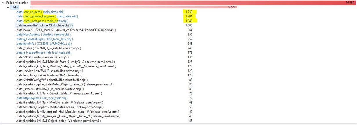

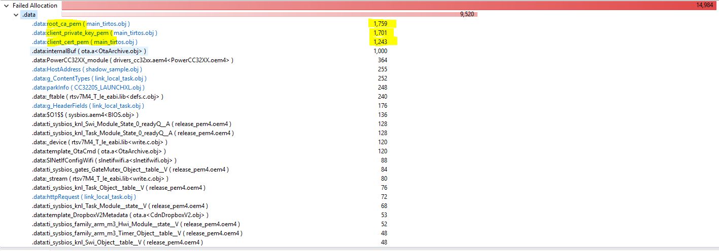

    Another big chunk of memory is consumed by certificates for AWS. My code is based on "shadow_sample" example and in that example certificates are stored in "certs.h" file and that takes a lot of memory as you can see in the below screenshot:
    Do you know if there is a good reason to move those certificates into external flash?
    Thanks for your valuable advice.
    David
  • Hi David,
    I am not familiar about AWS examples, from this reason I can give you only common advices how to decrease utilization of RAM.
    - yes , disabling debug messages from libraries will save few valuable kB of RAM
    - enabling optimization in compiler decrease size of code
    - place of section and stack size is configurable via linker file inside your project (*.cmd file). Information about stack requirements can give you stack peak in ROV
    - moving certificates from RAM into sFlash will save small piece or RAM also. I am not sure how much of space you can save. You need to try it.
    - you should check if you not use some long strings inside your code. Moving long strings into sFlash can save some memory.
    - you can try optimise RTOS configuration (e.g. use minimalistic exception handler, reduces the .const footprint, etc.)
    Jan
  • Hi Jan,
    By moving .data section into SRAM0 and decreasing size of heap from 32kb to 24kb solved th ememory problem.
