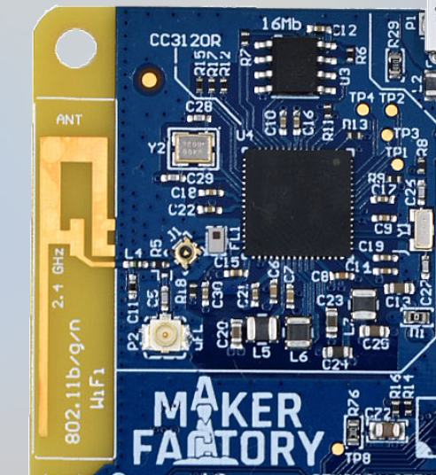

My board is a custom design, based on the CC3120 Wide-Voltage Mode Application circuit (CC3120BOOST Schematic)
The layout follows very closely on the critical parts the CC3120BOOST one (SPRCAF9), Vcc=3.3V with <30mV ripple.

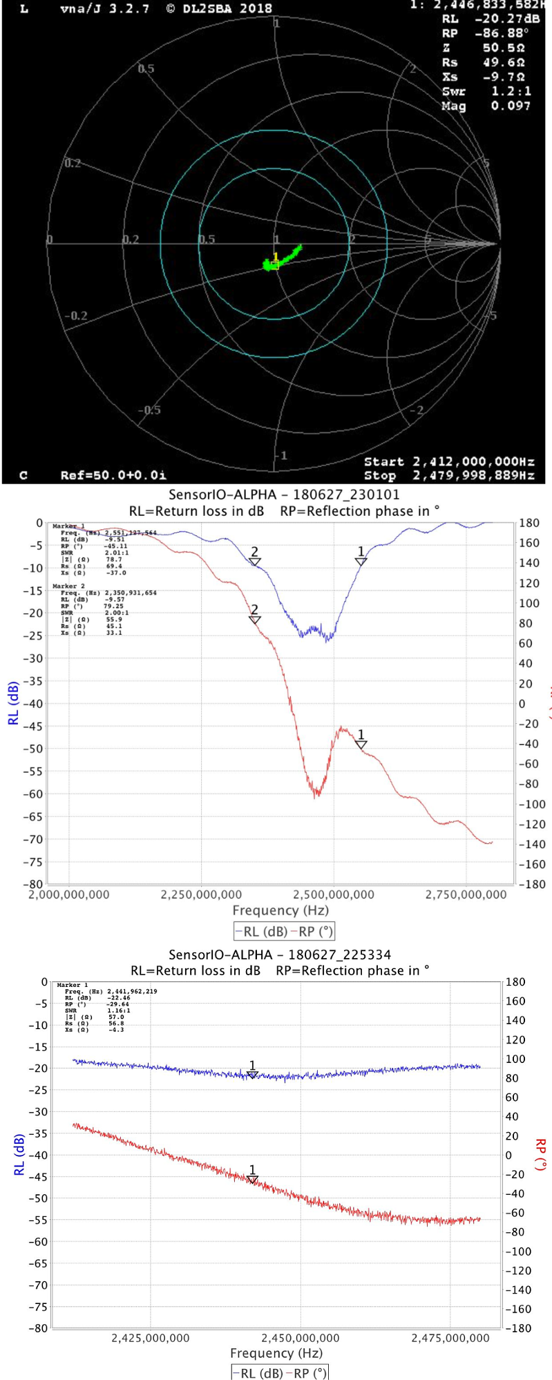

I'm attaching pictures of the PCB and the antenna matching measurements (return loss on the RFBG pin31, looks much better than with chip antennas) in case it's useful.

  • Hi Michael,
    I still need to make a few more tests with different router brands for confirmation, but it seems that the disconnection issue was actually caused by a small shift on the 40MHz clock:
    During the schematics design and boards assembly we couldn't source the XTALs recommended on the datasheet, so we are using the FL4000157Z from DiodesIncorporated. The XTAL complies with the specifications on the datasheet (ppm, ESR, etc.), but the calibration load capacitance is different than the used in your reference designs, so I needed to tune the oscillator by changing the load capacitors (using this doc which I found very useful).
    It seems that some routers were more forbidding with this carrier frequency shifts than others...
    Thanks a lot for your support!
