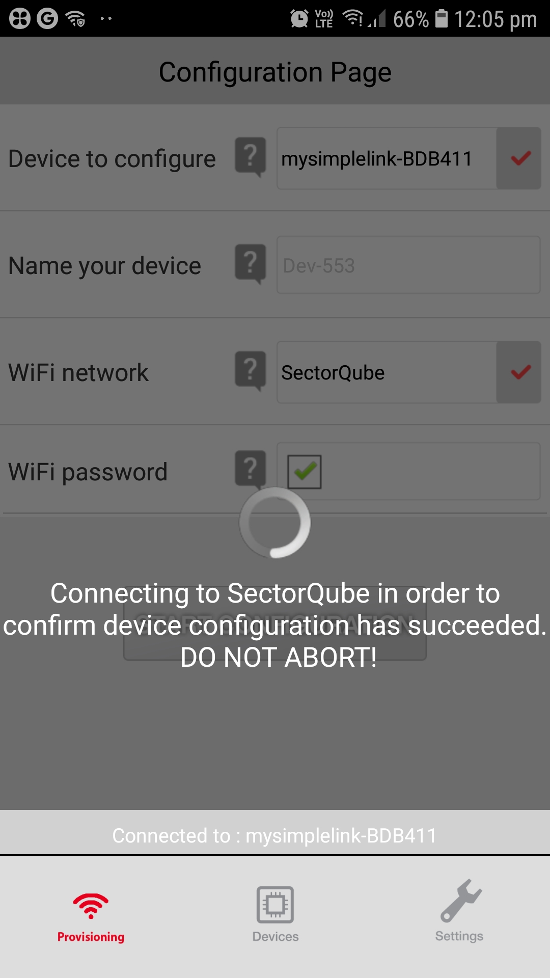

CC3200: provisioning_ap example not working
Part Number: CC3200
I am using the cc3200 launchpad and the SimpleLink Starter Pro  android app. I have flashed the provisioning_ap example in the CC3200SDK_1.3.0 and also the service pack. when I run the program it starts as an access point. I connected my phone to this access point and opened the SimpleLink Starter Pro app. The app detected that I was connected to the launchpad and automatically filled the "Device to configure" box. when I clicked the "WiFi network" box it didn't show any WiFi networks even though there were several  WiFi routers nearby(Fig.1). So I manually typed in the WiFi credentials and hit "Start Configuration". after some time my phone automatically connected to the Wifi router. But the launchpad was still in ap mode. There was nothing new in the terminal. not even errors. why is this? please help.

  • Hi Kobi,
    I tried the app in android version 6, 8 and 9. The above screenshots is from android 8.1(Samsung).
    Yes the "Enable Smart Config" was disabled.
    Yes I did try the refresh button.
    Can you suggest anything that I should try?
    regards.

  • Hi Kobi,
    The logs are similar to those in the screenshot.
    		       CC3200 AP Provisioning Application
    Host Driver Version: 1.0.1.11
    Build Version 2.10.0.0.31.1.5.0.2.1.0.3.37
    Device is configured in default state
    Device started as STATION
    Starting Provisioning..
    [NETAPP EVENT] IP Acquired: IP=192.168.1.1 , Gateway=192.168.1.1
    [NETAPP EVENT] IP Leased to Client: IP=192.168.1.2

  • Hi Arun,
    Try to recompile the Simplelink (Wi-Fi host driver) in the NON_OS configuration (you can import the Simplelink project from the SDK).
    Make sure the following lines are included in the "Simplelink/user.h":
    #include "provisioning_api.h"
    #define SL_EXT_LIB_1 sl_Provisioning
    Once the driver is built (to "ccs/NON_OS/simplelink.a"), make sure that "provisioning_ap" application links with the right lib (i.e. check the path definition in the project Properties->Build->ARM Linker->File Search Path).
    If you make sure that the SL_EXT_LIB_1 is enabled in your simpleline.a this should work (I've just verified this ).
    Br,
    Kobi
  • Hi Kobi,
    It worked!
    after setting properties->general->configuration to NON_OS active and rebuilding the simplelink project have made it to work. Other changes you have mentioned were already done.
    Thanks for the solution.
