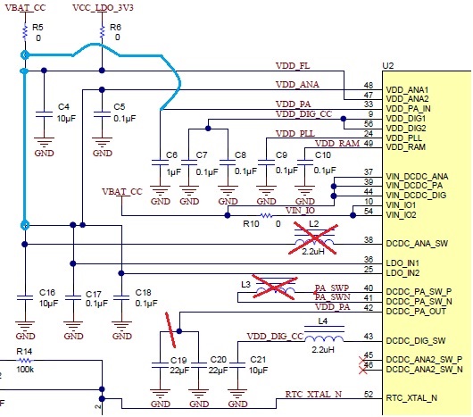

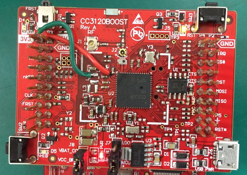

  • Dear  Josh
    CC31XXEMUBOOST modify to 1.85V
    remove J4 & supply 1.89V to J4 pin 1
    measure CC3120BOOST Header P1.1 has 1.89V voltage
    CC3120BOOST bias 3.3V modify to 1.85 V
    schematic modify as below
    remove L2 (VDD_ANA) , L3 (VDD_PA) ,  (Red X mark)
    cuf off  the power trace between C19 & C20  (VDD_PA) (Red slash)
    connect pin 33 (VDD_PA) & C16(VDD_ANA) to VBAT_CC  (Blue wire)
    PCB modify as below
    remove L2 (VDD_ANA) , L3 (VDD_PA) (yellow rectangle)
    cuf off  the power trace between C19 & C20  (VDD_PA) (green slash)
    connect pin 33 (VDD_PA) & C16(VDD_ANA) to VBAT_CC  (gray rectangle & black wire)

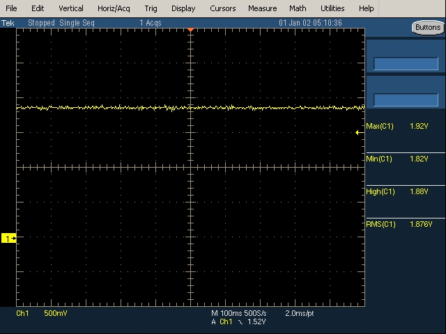

  • Jo,
    What Power supply are you using for the 1.85 Power Supply? Can you measure the voltage using an oscilloscope when you turn TX on? I would like to see if voltage dips when you try to Transmit.
    VR

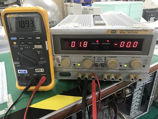

  • Dear VR
    The model of power supply we used are GW GPC-3030D and we measure voltage at supply is 1.893V as below.
    We measure voltage at CC3120BOOST header P1.1 is 1.890V as below

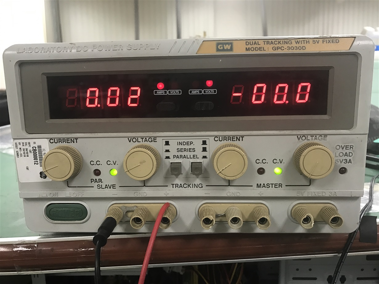

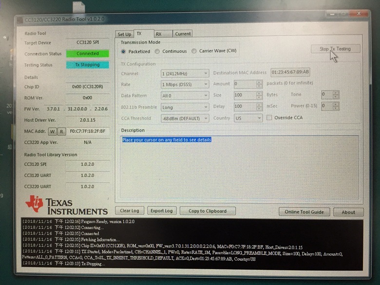

    When Radio tool connect to CC3120BOOST, we measure voltage by oscilloscope show as below
    When Radio tool press TX start, we measure voltage by oscilloscope show as below
    The voltage drop only 0.02V at minimun & 0.004V at RMS. The voltage at Max & High are the same.
    When press TX stop, the tool will crash.
    The voltage is only drop  0.02V at minimun & 0.003V at RMS. The voltage at Max & High are the same.
    We thnik the trancesciver doesn't tramsmit any signal because the power supply show current only around 20mA.
    BR.
    Youwin
  • Hi Youwin,
    To be on the safe side, I recommend starting with a new board and making the following modifications:
    On the CC3120BOOST:
    1. remove L2 and L3
    2. cut the trace going to C19
    3. Solder a wire from VDD_ANA net (I chose the top side of L2) to P1.1
    Solder a wire from the VDD_PA net (I chose the bottom side of C6) to P1.1
    On the CC31xxEMUBOOST:
    1. Remove the jumper on J4 and provide 1.89VDC to pin 1(VCC_BP) and a common ground
    I was able to successfully flash the servicepack and transmit using Radio Tool with these modifications.
    Alexis

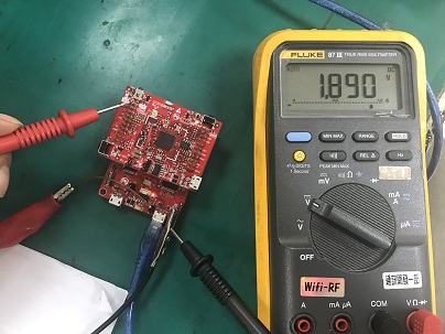

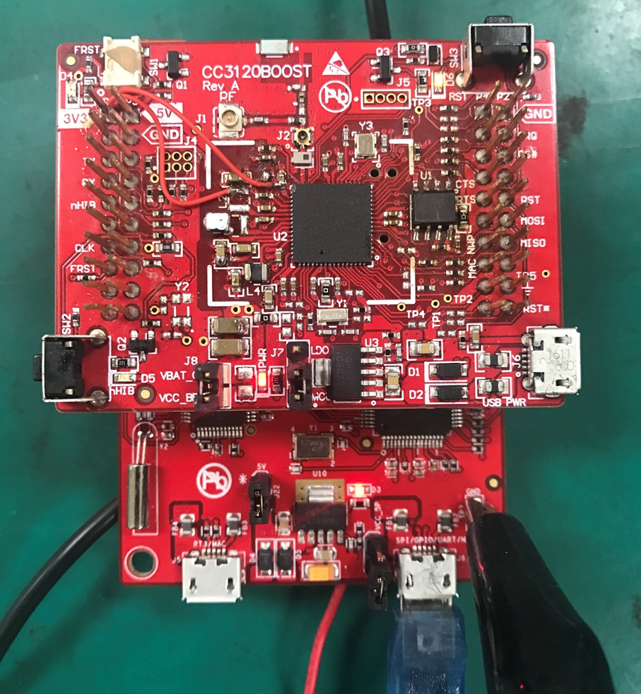

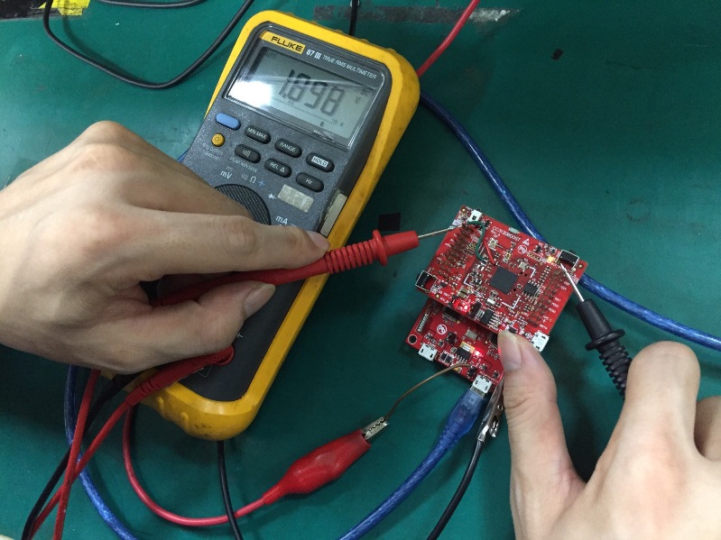

  • Dear Alexis
    We rework CC3120BOOST as yours
    and measure voltage of P1.1 as 1.898V
    but Radio tool TX function still crash
    BR.
    Youwin

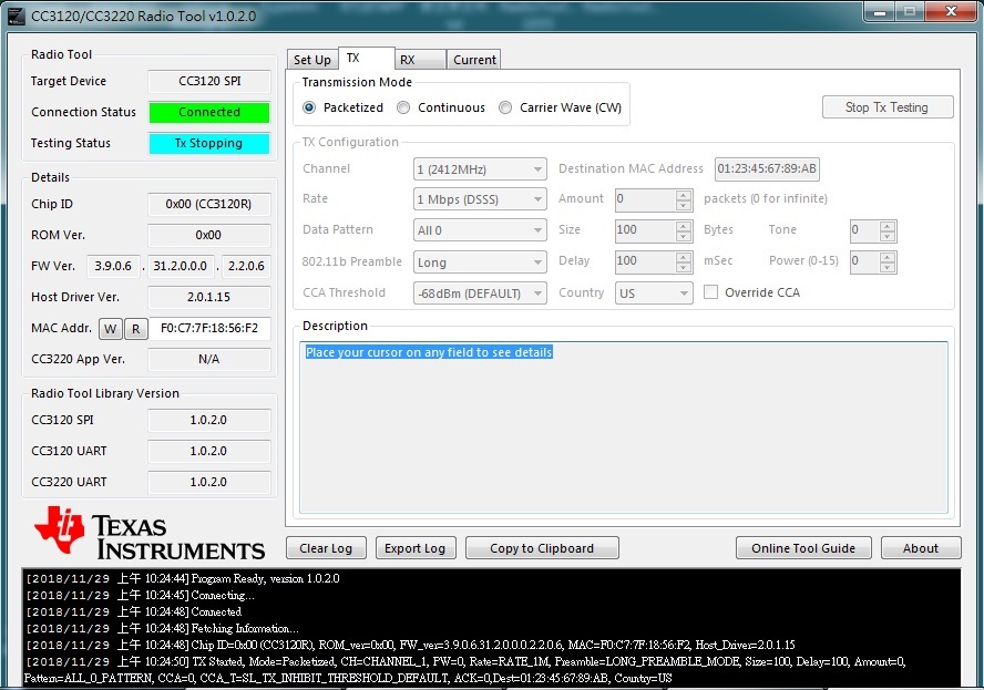

  • Hi Youwin,
    Form the image above it shows that you are connected? Can you help explain further what you mean by radio tool is crashing? Have you downloaded the latest from TI.com? What is the operating system you are using?
    Riz
  • Hi Youwin,
    Are you still having this issue? IF so we will send the board to Jo.
    Riz

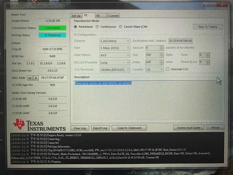

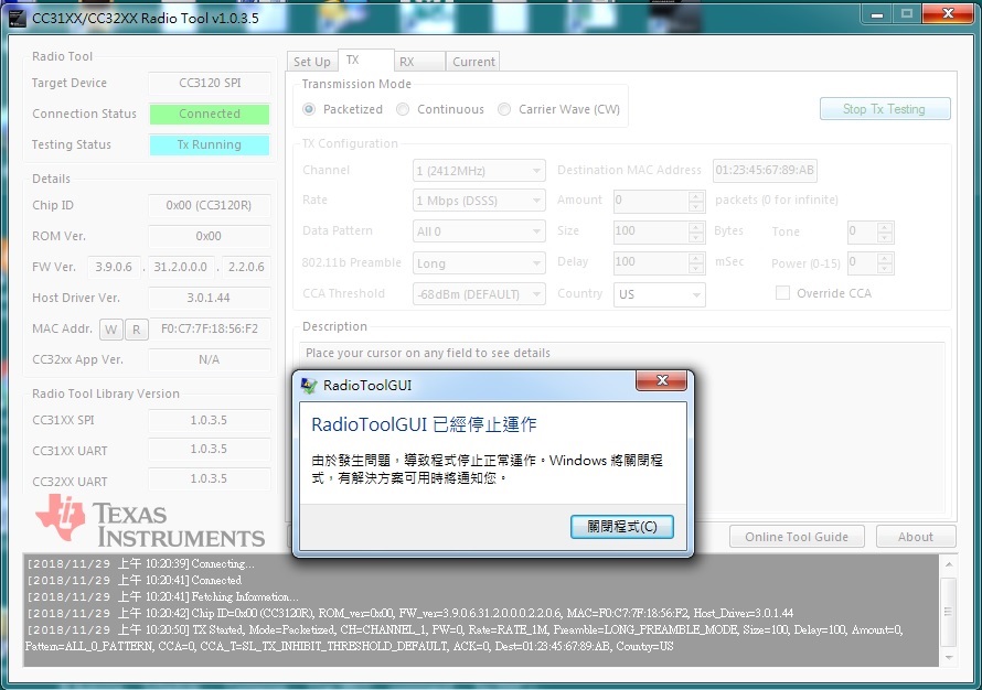

  • Dear Riz
    I reply as below
    Yes, We connected CC3120BOOST. We can see at picture of Radio tool.
    We press TX stop and didn't get it stop and sometime will see it report stop operation

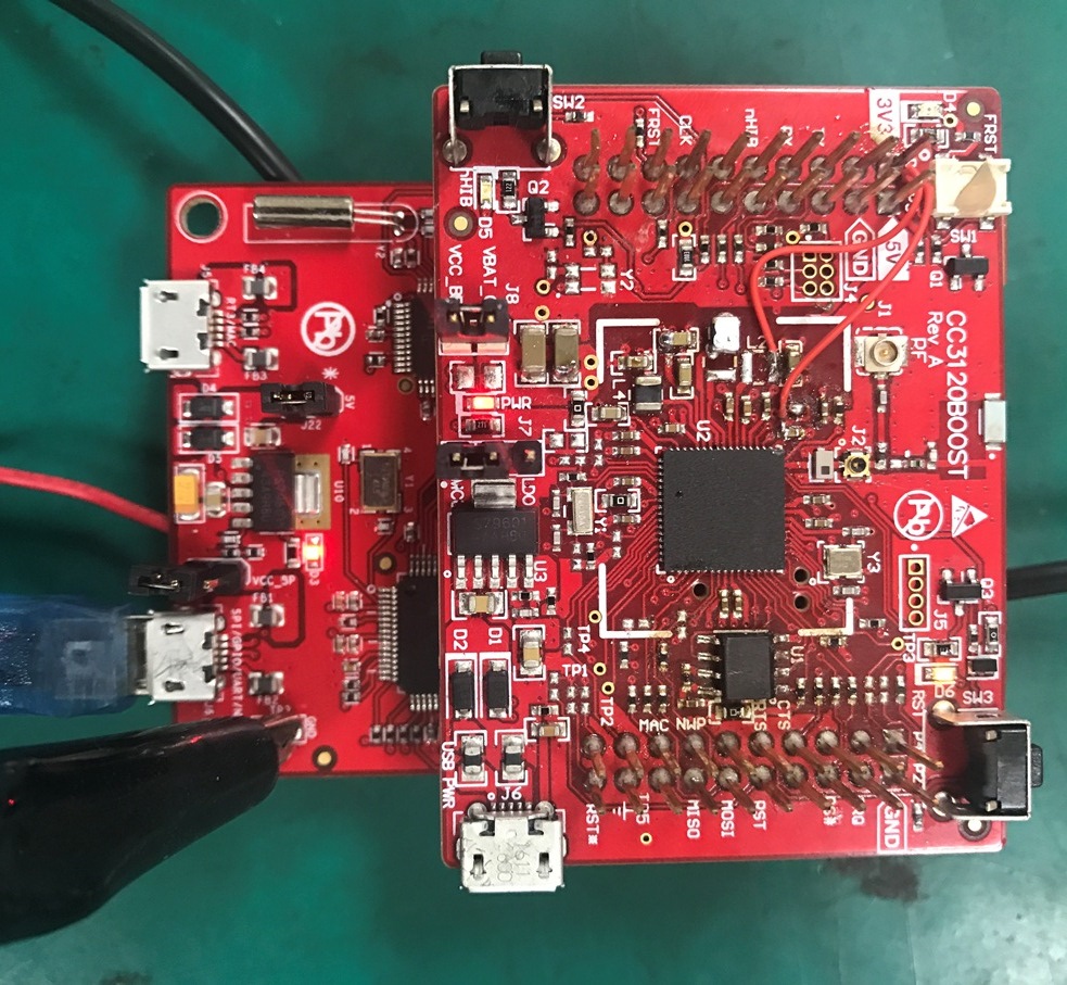

    We test the latest SP 3.9.3.6 below
    We change to another CC3120BOOST board and use uniflash upgrade to FW 3.9.0.6
    And rework to 1.89V circuit as below photo
    And use Tx of Radio tool 1.0.2.0 (SPI interface) to control and it still hang (can't stop and no RF signal)
    And use Tx of Radio tool 1.0.3.5 (UART interface) to control and it will report Radio tool Stop operation

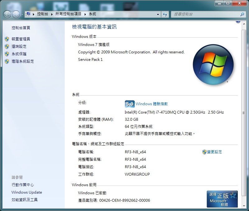

    Windows 7 enterprise 2009 SP1 64bit as below picture
    BR.
    Youwin
