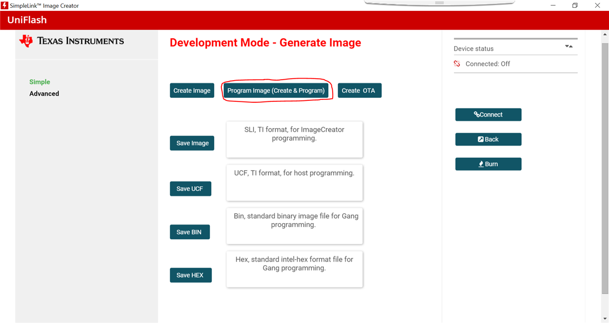

  • Hi Stomp,
    Can you verify that you are clicking the "Program Image (Create & Program)" button after you click the Burn button in step 8 of your process?
    Alexis
  • Hi Alexis,
    Yes that step has been completed and upon re-connecting my device I can view the user files.
    My questions still remain though, especially how do I debug the boot process if it fails?
    Stomp!.
