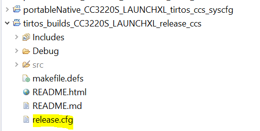

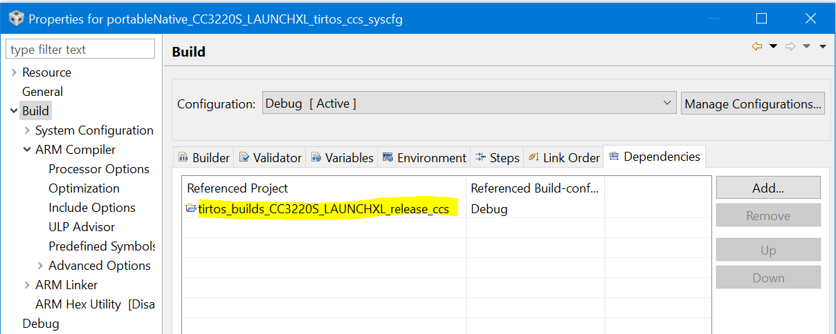

  • Hi Stuart,
    Both the UDP Echo and portable example use the 2 project approach. The .cfg is in the kernel project. Here is a picture of the two projects.
    Then if you look at the project properties in the application project (portableNative in the above pic), you see how the projects are hooked together.
    So you can take the UDP Echo example in the SimpleLink SDK and then modify the kernel project's .cfg as needed. You can add the .cfg into the application project also (copy .cfg into project and then do a couple things to the project settings...here's a writeup if you want to go this route: ). The downside of adding the .cfg into the application project is that it is a one-way street. You cannot remove the .cfg from that application project.
    Todd
