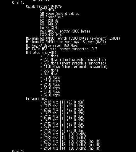

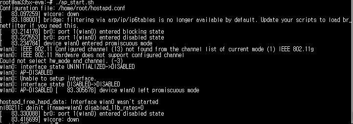

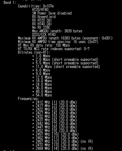

* GATEWAY Side
1. 13-Ch does not work.(No-Enable)

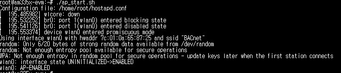

enable channel 13 with ap mode in this state, the following error message occurs and it is not enabled.
After that, I tried to connect to ap on channel 13 in station mode.
I'm check the iw list. after connecting, i can see that the contents are changed to channel 13
At this time change to AP mode at this time, 13 Channel will be enable.(you can see channel 13 as below.)
-> Which part should I modify to enable channel 13 in AP mode?
-> The result is the same even if I change the country code to EU or Others (Not US)

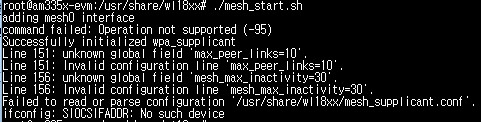

* Receiver Side
1. Bridge is not connected to Wlan0 and Eth0.
   I tried to perform a bridge operation through a mesh connection, but a mesh error occurred
-> Which part should I modify to enable channel Wlan and Eth Bridge Mode in Station Mode?

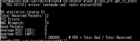

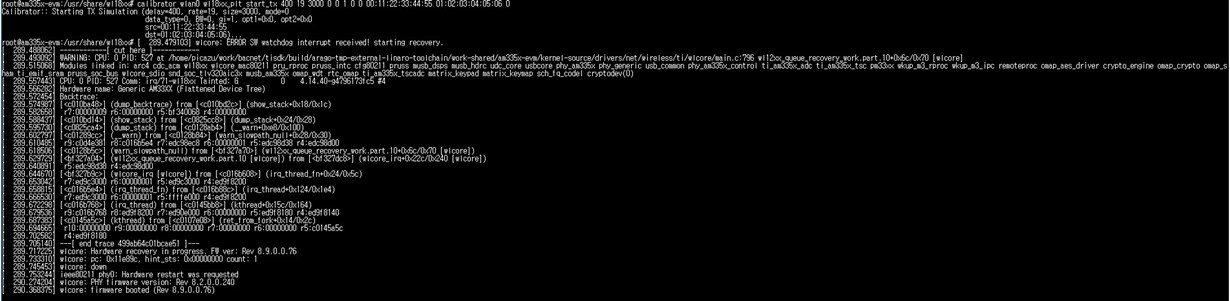

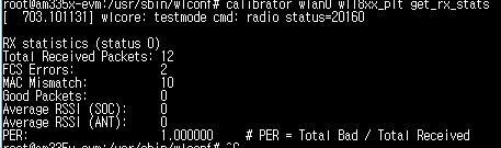

* WiFi Test Mode
1. Tx & RX Test Mode Enable Fail
Test_Mode Enable Set
TX
RX
-> Why is the calibrator wlan0 plt power_mode on command not working?
-> Is there a Process Guide document for DUT testing?
-> Do you have an example of measuring WiFi RF characteristics with Litepoint IQnxn or IQxel?
