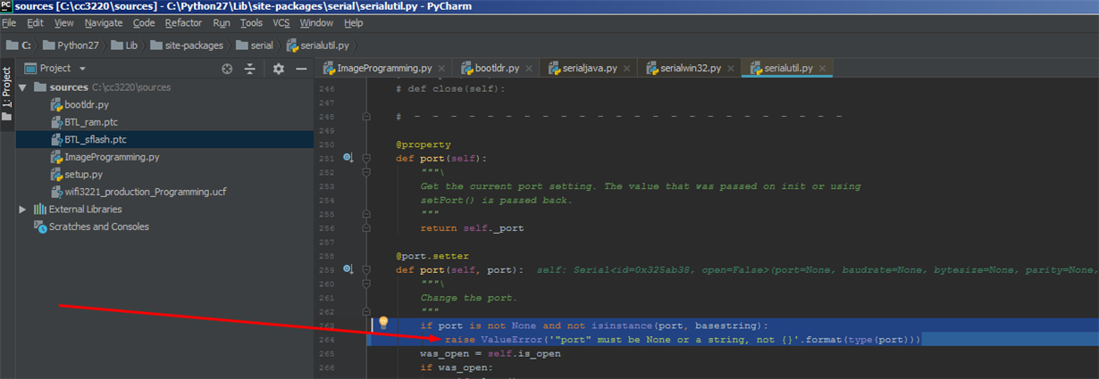

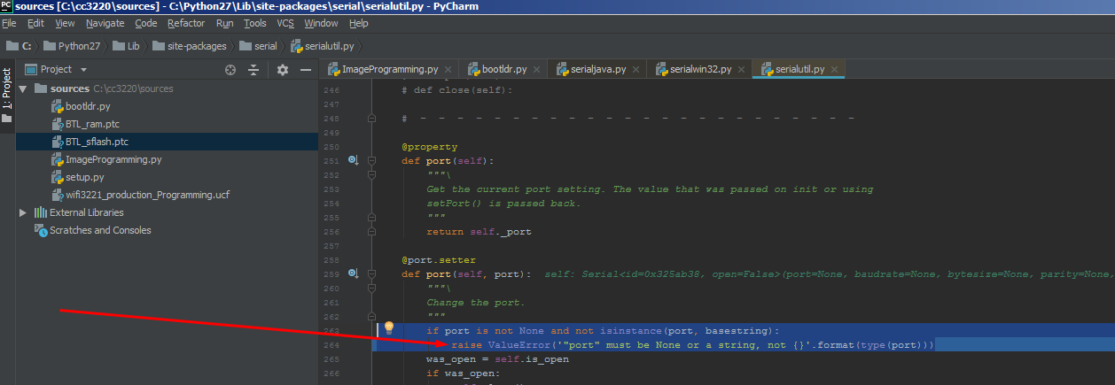

    Do you have any experience with Python language or any other OOP language? Your questions are related to fundamentals to Python itself. To be able made changes at Python code you need to go through tutorials to Python (e.g. www.python.org/.../gettingstarted). I am not sure what do you expecting. In case of that you want do embedded programming from Windows machine, you can use ImageProgramming.exe without any limitation. In case you want change Python script to add some requested features, you need to know Python including ways how can be debugged.
    Image below is from source of pySerial library. Please read more about keyword "raise" here docs.python.org/.../errors.html
    Jan
  • i have a little
    i found some mistakes:
    was
    self.com_port = com_port
    self.comm = serial.Serial(port=( self.com_port-1), baudrate=self.baudrate, timeout=15, parity=serial.PARITY_NONE, stopbits=serial.STOPBITS_ONE)
    now
    self.com_port = ('COM%s' % com_port)
    self.comm = serial.Serial(port=( self.com_port), baudrate=self.baudrate, timeout=15, parity=serial.PARITY_NONE, stopbits=serial.STOPBITS_ONE)

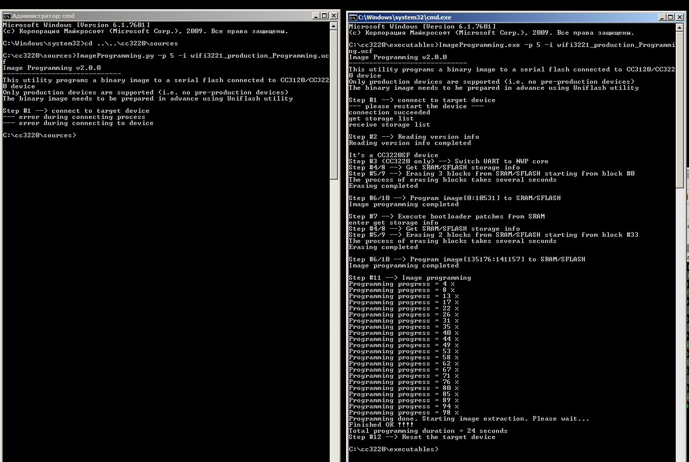

    and right now i have
    Microsoft Windows [Version 6.1.7601]
    (c) Корпорация Майкрософт (Microsoft Corp.), 2009. Все права защищены.
    C:\cc3220\sources>ImageProgramming.py -p5 -i wifi3221_production_Programming.ucf
     -v
    Image Programming v2.0.0
    This utility programs a binary image to a serial flash connected to CC3120/CC322
    0 device
    Only production devices are supported (i.e. no pre-production devices)
    The binary image needs to be prepared in advance using Uniflash utility
    Step #1 --> connect to target device
    port opened
    wait and clear uart rx buffer
    set break signal
    --- error during connecting process
    --- error during connecting to device
    C:\cc3220\sources>
    wait timer doesn't work
    i think *.py and *.exe sources are different
    Source from embedded programming package works without any issue. I tested it now. No modification is required.

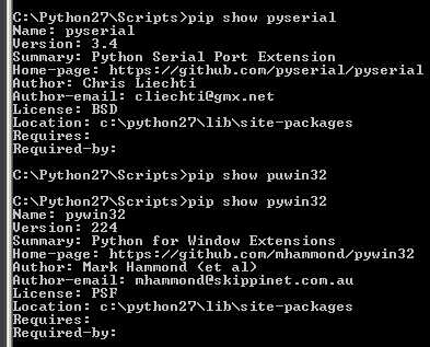

  • python 2.7.15
    pySerial-2.7
    pywin32-224.win32-py2.7
    can you give me all your *.py files "as is" for check the difference by WinMerge?
    It looks that you have installed latest version of pySerial (version 3.4). I tested with old version 2.7 from 2013. I expect that this is not important, but I don't investigated that.

  • >>>  I expect that this is not important, but I don't investigated that.
    i have installed pyserial 2,7 and my script works.
    Sorry I don't understand what you want to say.
    Used versions for scripts are described at CC3x20embeddedimageprogrammingexamp_manifest.html inside embedded programming package (2.7.3, 0.6.9).
