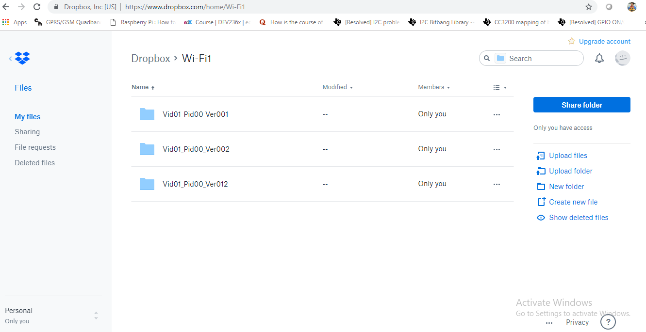

    One more thing, shall I add the both files in dropbox (f00_sys_servicepack.signed.bin and f43_sys_servicepack.ucf files)?

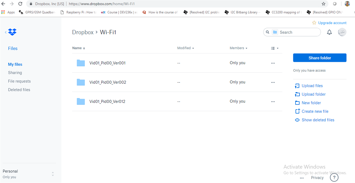

  • Hi Kobi,
    I am following the all the steps of the OTA app notes. I have updated the buffer size of OtaHttp.h, CdnClient.c, ota_api.h, uncommented the "#define DEBUG_PRINT" and commented the "Message("\033[2J\033[H\033[?25l");". I am rebuilding the OTA app and OTA_update after changing of these things.
    I updated the token generated also.
    I generated the App in "App folder" section in Dropbox.
    My default Nwp version is 2.0.7.0.31.0.0.4.1.1.5.3.3. My service pack's Nwp version is 2.2.0.1.31.1.2.0.2.1.0.3.23. This should update into the application.
    I have uploaded the files in Dropbox which are:
    Vid01_Pid00_Ver0000
    - f00_sys_servicepack.sig
    - f43_sys_servicepack.ucf
    Vid01_Pid00_Ver0001
    - f80_sys_mcuimgA.bin
    #define OTA_VENDOR_STRING               "Vid01_Pid00_Ver01"
    #define APP_VER_BUILD           1
    Vid01_Pid00_Ver0101
    #define OTA_VENDOR_STRING               "Vid01_Pid00_Ver00"
    #define APP_VER_BUILD           0
    I am getting the notification of OTA update in OTA Update Status. But, I am not seeing anything into log file update of Nwp and App Version.

    Can I know which step, I am not following? Where am I wrong here? How much time does it take to reboot? I have gone through all the post of TI forum regarding this topic. But, none of solution is helpful for me.
    One thing more, I have observed that I am getting the error - 6 in iRet = sl_extLib_OtaRun(pvOtaApp); before completion of OTA update. After this error, I am getting the iRet  value 2. After that, I get the message of OTA completion.
    Please provide the full terminal log of the OTA process (attach a text file).
