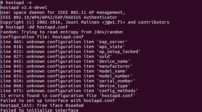

We tries to enable ACS mode for WL1807MOD with hostapd R8.7_SP3 cloned from TI repo, because this version of hostapd has mentioned as working in the related e2e post.
But following error appears after hostapd start:
I also attach our hostapd configuration file and more detailed hostapd log.

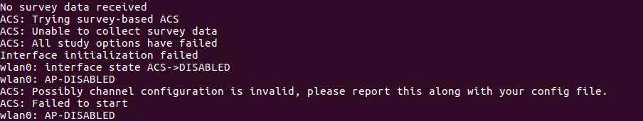

ACS: Using survey based algorithm (acs_num_scans=1)
nl80211: Fetch survey data
wlan0: Event SURVEY (46) received
No survey data received
ACS: Trying survey-based ACS
ACS: Unable to collect survey data
ACS: All study options have failed
Interface initialization failed
wlan0: interface state ACS->DISABLED
wlan0: AP-DISABLED
ACS: Possibly channel configuration is invalid, please report this along with your config file.
ACS: Failed to start
wlan0: AP-DISABLED

Can anybody help me to solve this issue?
