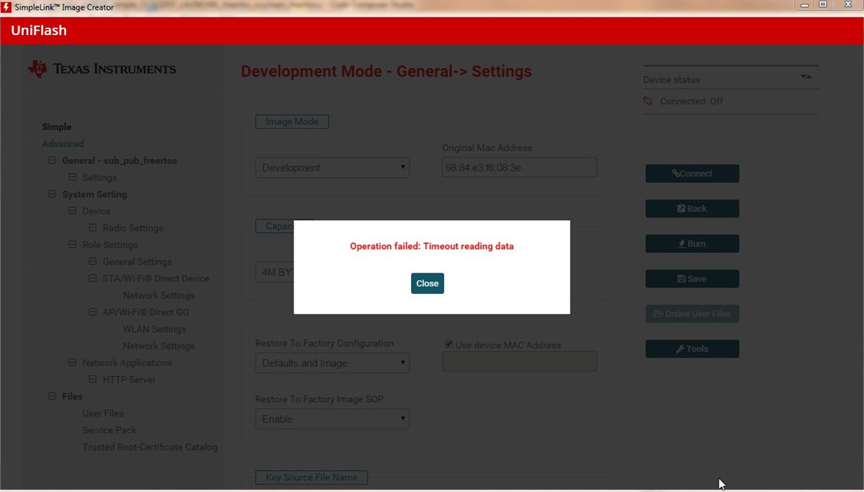

HI TI team,
We have CC3220SF-LAUNCHXL with us where we are doing our proto firmware with it, and meanwhile I have designed a PCB using CC3220MODASF12MONR module.
1). So, how can I use XDS110 emulator which is there in the CC3220SF-LAUNCHXL to program to our CC3220MODASF12MONR) module?.
2). and also we have J-link segger emulator with us, can I use this to program our board?
and also Using uni flash tool, how can I program our module?
Kindly support on this

    I believe you will find this thread useful to program the CC3220MOD.
    We do not recommend using J-link for the CC3XXX because there is limited support for it and you will not be able to program the external flash with it.

  • Hi Jesu,
    Thanks for your response,
    What I'm trying to do is.
    I have a CC3220SF-LAUNCHX and a customized board which is designed by us.
    I wanted to write code into our customized pcb which comprises of CC3220MODASF12MONR  module .
    So, I have taken out JTAG pins from the launch pad- J4 connector XDS110 out and connected to our customized PCB.
    Attached files are the problems which we were getting when we try to program our customized board using XDS110 emulator which is there in the launch pad with both Uniflash and CCS.
    I have cross checked the hardware connections.
    Kindly support on this.
    Do you have connected UART? You need to use UART and via Uniflash switch your module into development mode. After that you will be able use JTAG from CCS.
