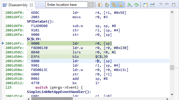

    Within this function, the pCdnClient->state is CDN_STATE_FILE_DOWNLOAD_AND_SAVE, but after stepping into the switch, the debugger starts acting strange, as if I had order it to run.
    If I pause the execution, the program seems to be in a SPIDataGet() function. The source file can't be found, but the Disassembly window shows this:
    If I "assembly step", the program stays in an endless loop in the four green statements after $C$L39
    This is how far I could get while debugging. May the problem be solved if I change from dropbox to another hosting platform?

  • Update. This is the code of the loop where the function gets stuck
    //! Waits for the word to be received on the specified port.
    //! \param ulBase is the base address of the SPI module.
    //! \param pulData is pointer to receive data variable.
    //! This function gets a SPI word from the receive FIFO for the specified
    //! port.  If there is no word available, this function waits until a
    //! word is received before returning.
    //! \return Returns the word read from the specified port, cast as an
    //! \e unsigned long.
    void
    SPIDataGet(unsigned long ulBase, unsigned long *pulData)
      // Wait for Rx data
      while(!(HWREG(ulBase + MCSPI_O_CH0STAT) & MCSPI_CH0STAT_RXS))
      // Read the value
      *pulData = HWREG(ulBase + MCSPI_O_RX0);
  • I don't know where the issue comes from, but it worked after a work around posted in a different question.
    "Changing the minDmaTransferSize from 100 to something so high that the driver should never use DMA (4096 bytes)."
