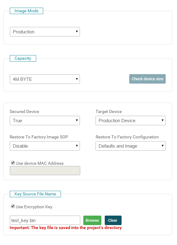

    Thanks for your response.  I followed your steps and I was able to create an encrypted image and then I issues the activate command which said it activated the image but I have a few questions.
    1. When I program the encrypted image to a device should it boot if I don't issue an activate command?  Because when I programmed the encrypted image it did boot after I reset my board.  My thought would be that I would need to issue an activate command in order for my image to boot if it was encrypted.  It was a production image that I encrypted.  Does my board need to be setup a certain way for this to work?  Here is a screenshot of my setup:

  • Hi Kevin,
    1) The program command that I mentioned does both - it programs the image and uses the key file to activate the image. Did you program it in a different way?
    2) No, I don't believe this is supported at the moment. I can double check.
