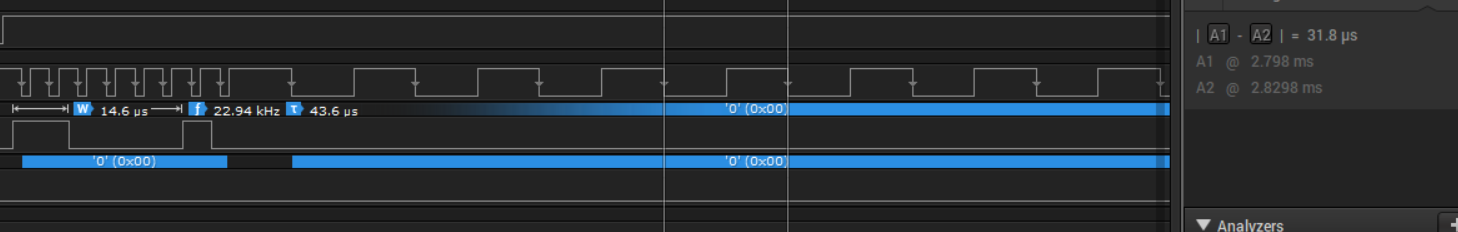

  • Hi Michael,
    1) I am using pin 5 (GPIO_14 ) as my SPI clock, can I produce PWM waveform on this pin.
    If I can use PWM on the same line, please suggest how can I do it.
    2) Another way is, Instead of using SPI libraries, I am using all 4 pins as GPIOs. I am able to write and read data, mainly I can vary clock just after writing 0xC2 command, the problem with this is the GPIO toggling is it's not consistent, I am not meeting the timing, my requirement is, I need 32us for each cycle. sometimes I am getting 32us and sometimes I am getting 31.8us.
    Please see the below snapshots for the same
    The delay in the code is the same between the toggles. still, I see the time differences.
    Is it because of the latencies added by GPIO_toggle function. If so can you suggest me any alternate methods?
    Thank you,
    Kishore.
  • Hi Kishore,
    Given that the peripheral that have is using the SPI clock signal as the reference clock for its calibration, I don't think that you will want to use GPIO toggling in software as you will most likely be unable to get the timing within the tolerances of your device. I suggest setting up the PWM.
    Unfortunately, pin 5 cannot be configured as a PWM pin. You will need to use another pin that does support being configured as PWM. If you look at Table 16-7 of the TRM:
    www.ti.com/.../swru465.pdf
    You'll see the various multiplexing capabilities of each pin. For example, pin1 can be configured as a PWM output.
    Michael
